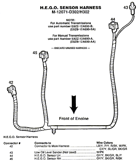

I need the O2 wiring harness from the female plug back to the O2 sensors. I have the other side of it from the male end back to the computer. I have exhausted all my contacts where I live at in Cincinnati to include junkyard. I really need this any help would be gratly appreciated.:bang:
this what u need ?
