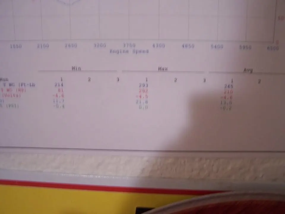

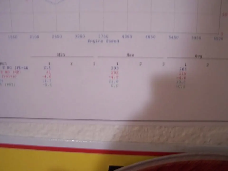

I have a Bliss 306 (NW ford guy), 9.5:1
edelbrock performer heads, RPMII manifold, trick flow stage 1 cam,
BBK 70mm tb, Pro-M 75mm MAF, Bosch 24# inj,
MSD 6-AL, accel CD-coil, low resistance wires (50 ohm/ft), Cu plugs,
LT headers, x-pipe. etc.
tuned on mustang loaded dyno

Redblur - it's hard to see that, but it loks like you did not twist it past 6,000 rpm (and it looks like the pull ended before it should have). It would be very interesting to see you put a pro-ported Performer on that engine and dyno again if you don't pull past 6,000 rpm.
Haha yeah, I cut the throttle at 6000RPM. I don't know much about the TF1 cam or the springs in the performer heads, and I have stock lifters, so I worry about valve float.
