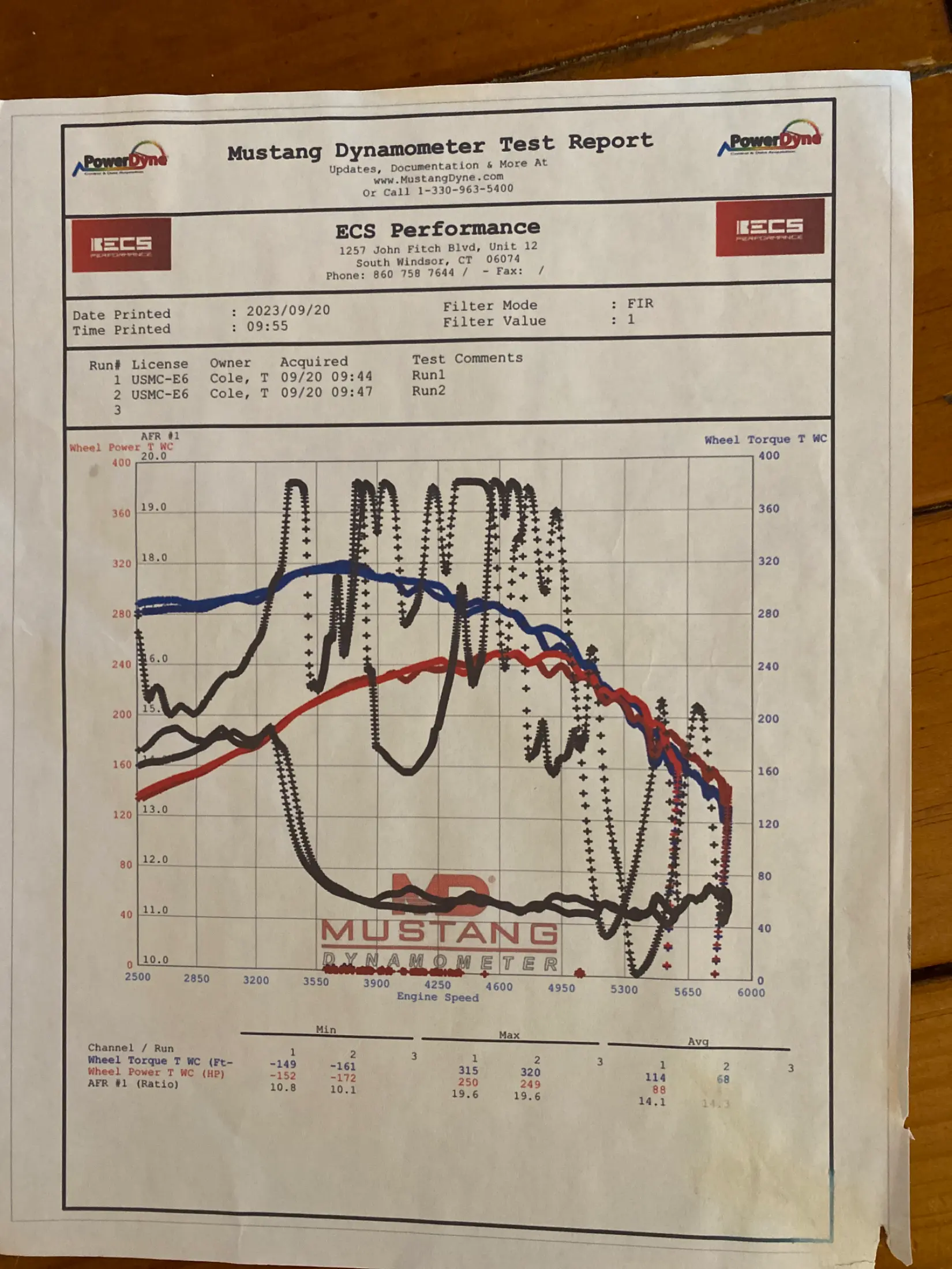

After trying everything, just a crazy idea, you might try putting the car on a dyno and see what the data says at 4k. ecs-performance in your town has a car dyno. Just a crazy idea.
Been there, done that. All they said is that it was misfiring. Not much help, I already knew that.
They work mostly on rice burner’s and know nothing about mustangs.
