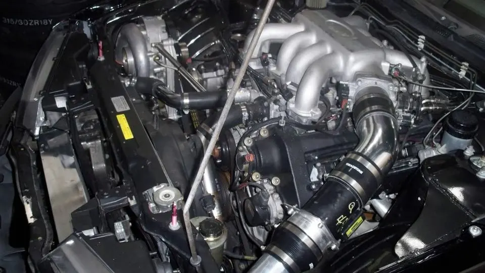

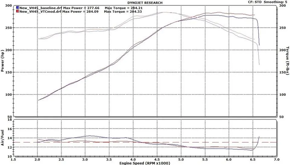

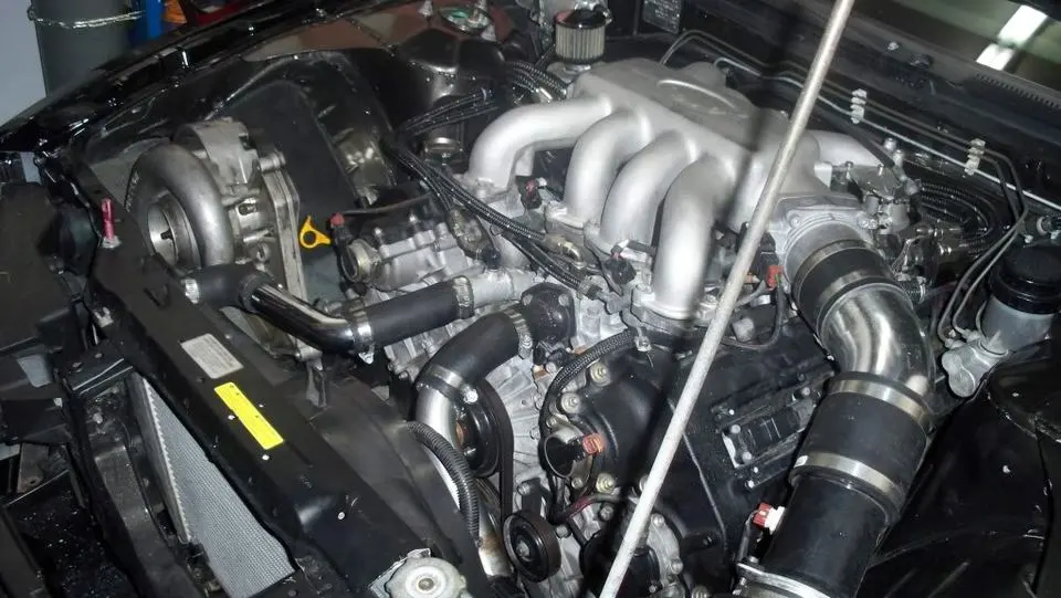

Hey guys, maybe you can help.
I know its not a mustang but i figured if any body would know you guys would.
I have a 240sx with a infinity q45 4.5 liter v8 stuffed in, i recently purchased a vortech v2 off of a 4.6 02 stang and am in the process of custom making the brackets for it, and was hoping you guys could point me in the direction for pulley size to reach my goal of 6-8 psi.
specs on the motor are
4.5 l v8 with 4v dohc
crank pulley 6.5 inches, it has the usual intake headers and dual 3 inch exhaust with xpipe.
motor currently makes 285 whp with a 7000rpm redline, do you guys have any idea and or point me in the right direction to figure the upper pulley size?
heres some pics and my dyno chart if it helps
engine
car
dyno sheet
thanks for looking

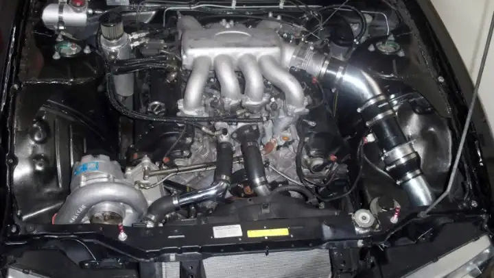

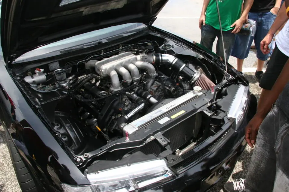

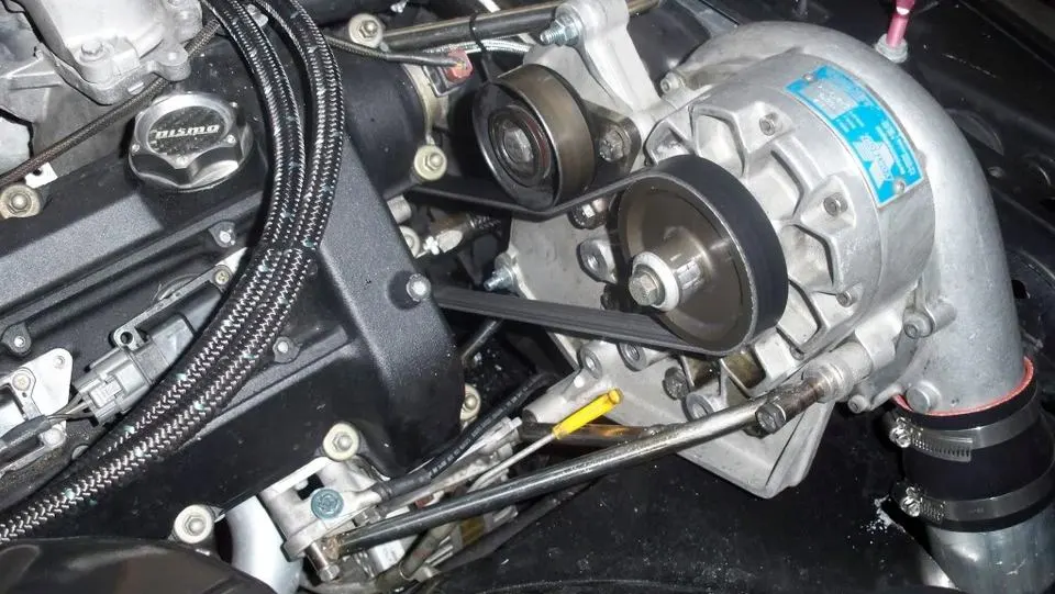

thanks for the help guy, i guess we will find out later next week, the sc is on and im just waiting on my tuned ecu, i left the 3.6 pulley on there, i hope it doesnt go over 8 psi
heres some pics

Yeah, that's pretty sweet. That engine sure has an interesting layout for its intake manifold...
Hopefully that supercharger bracketry is more reliable and robust than it first appears.

thanks, believe it or not i called vortech technical support and i was told " i have no clue". As for the brackets its made out of 1/2 stainless steel round bar, its on there nice and tight, and it has 4 pick up points and a 5th one on top its just missing from the picture.

I think you are going down the right path. From the looks of the engine in the OP's pics, it looks like a VH45DE which came in the 89-96 Q45. Very similar engine to the Mach 1. I don't know how strong their internals are however. Factory crank HP rating of 278HP I think?

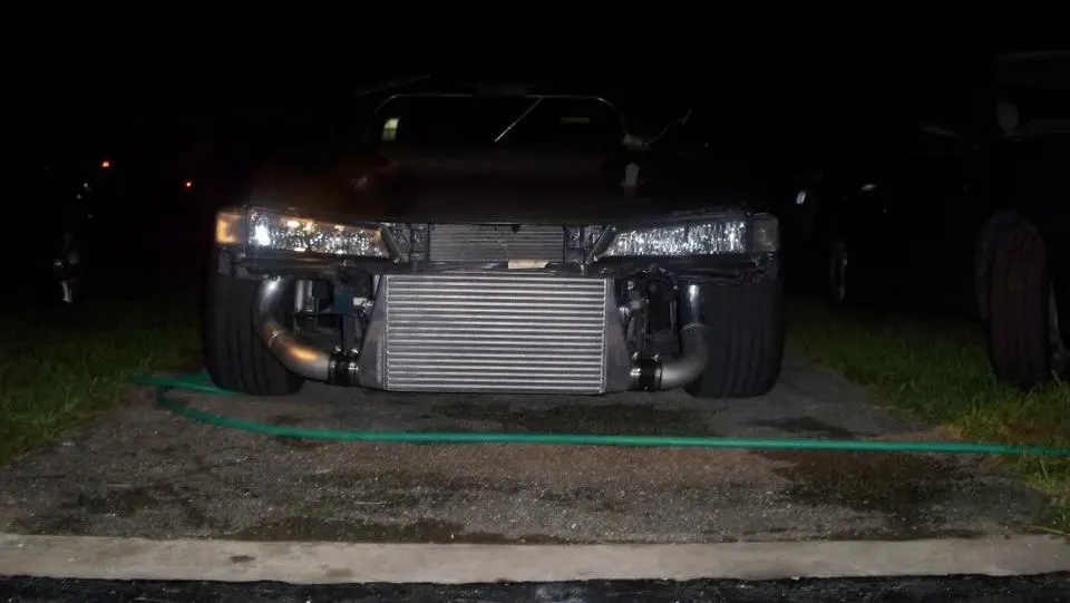

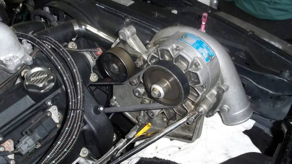

well i thought i should update this, took the car for a ride tonight, left on the pulley that came with it (3.6 inch) and it hit 8 psi a few times and once 9 psi, at 7000rpm. id like to be at 6-7 for now till i can get the tuning sorted out, what do you guys recomend.
Thanks in advance
Heres some pics of the finished product

Funny thing, i forgot that i had set my redline to 6500 rpm for the test drive (7000 is normal) and i hit 9 psi max at 6500 rpm, which was too much as it is, i can only assume its gonna get worse in the last 500rpm so i went ahead and ordered a billet 4.0 inch pulley hoping that will get me down to 6-7 psi at 7000rpm where i want to be.

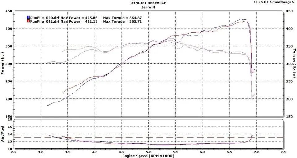

well guys thought i would update this..
The 4.0 inch pulley gave me exactly 6psi at 7200 rpm and the car picked up nice power, i wasnt expecting it to pick up power everywhere north of 3000rpm but id did. I had a few issues but got them worked out, here is the dyno sheet Thanks for the help again.

Your Ait to fuel ratio is scary.

scary rich or scary lean lol, it was pretty much 11.5-11.8 the whole way, at least thats what i have always run on boosted motors.
In what way? I thought it looked spot-on.

Your A/F looks fine for a boosted app - tastefully done car, with one hell of a combo under the hood. Welcome to the V8 world!
