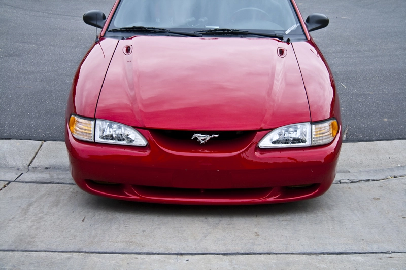

IMO, Every after market headlights from the SN95 looks like BS. IDK Why, but something just looks "Off" about them. Either the fitment is nasty, the quality looks like Poop, or the are a Knock off of the OEM design but look cheap. I am also not down with smoked headlights as for some reason i know they wont looks good on my SN95. So about 4 years ago i got a set of Brand new OEM GT lights and have been happy ever since. Made the car look amazing.

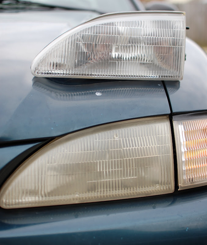

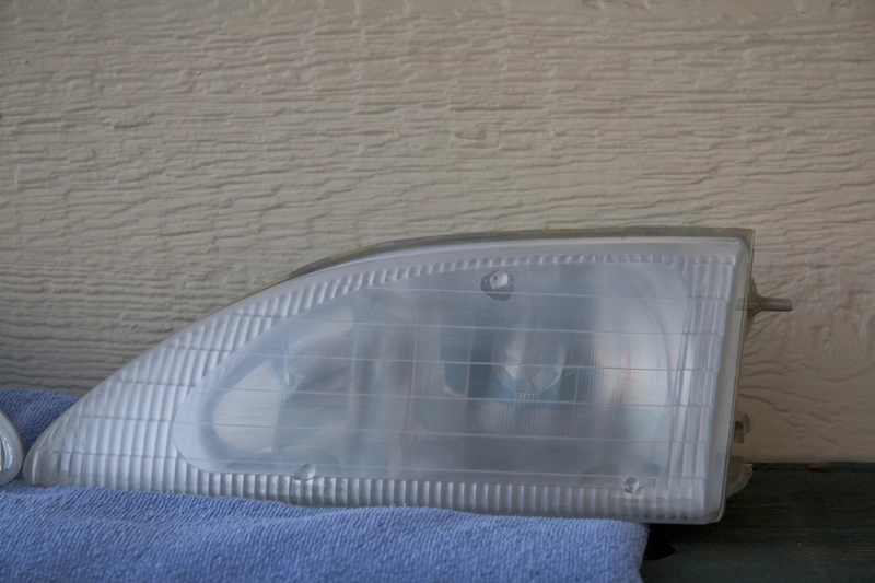

So I bought these from a Forum Member (Paul) for $65 Shipped. The lights were in great condition with little hazing, BUT since they are from Arizona they had LOTS of rock damage. This is even harder to fix then heavy hazing. In a picture the lights dont look that bad, but i know they could look Better.

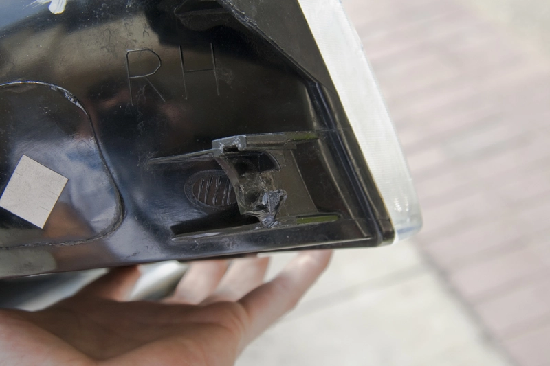

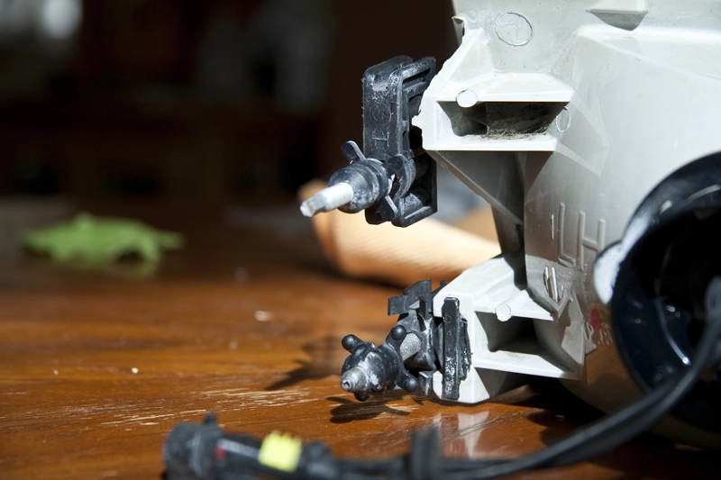

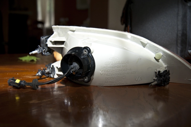

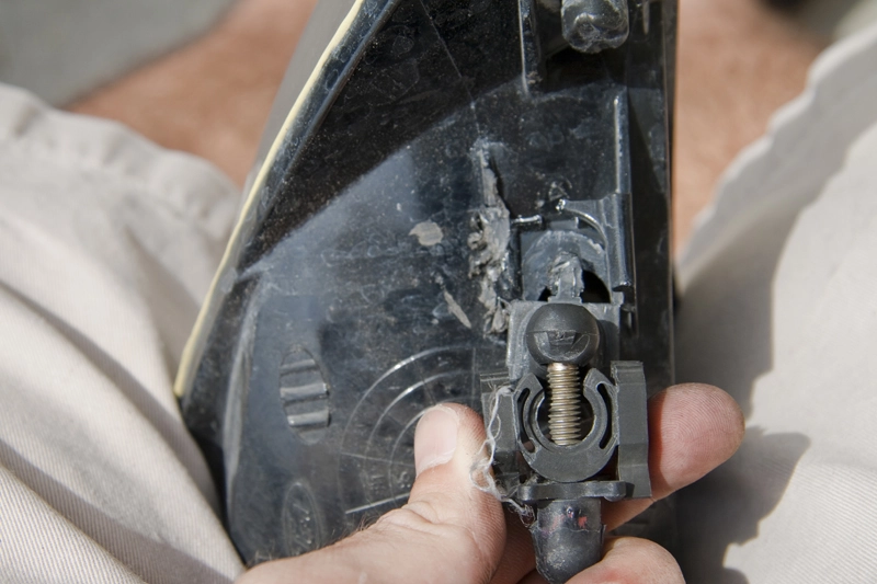

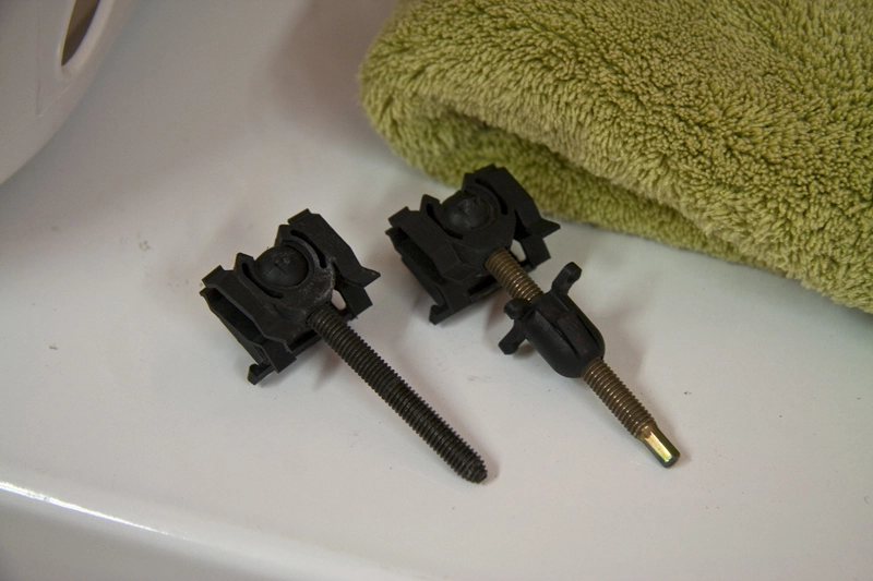

These lights also didnt come with any Adjuster pieces. Not just the removable one, but ALL 3!!! So now i am pretty F'd on how to get these adjuster pieces off my stock headlights. The **** adjusters were GLUED IN and i had to butcher my GT headlights to get these pieces off. I made it work, and after some cutting and screwdriver work, I had the pieces off.

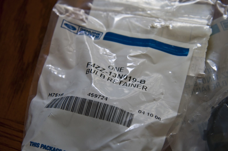

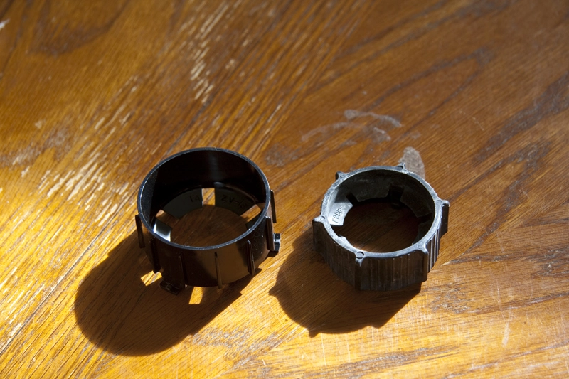

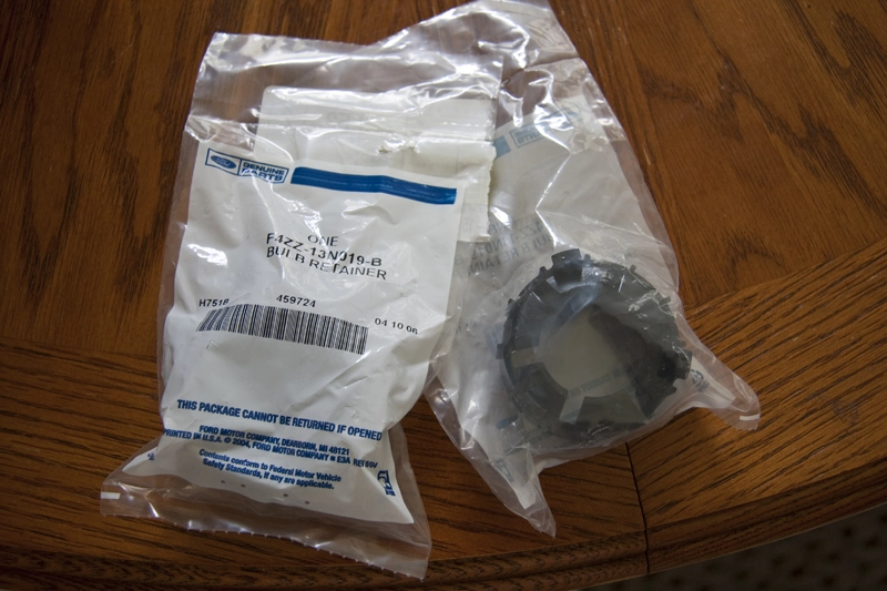

I also Found out that the Cobra Headlight Bulb retaining ring differs from the GT ring, and the Cobra ring didnt come with my headlights... So I had to go to The Stealership and order 2 pieces. they were overnighted from Mississippi. Cost: $20

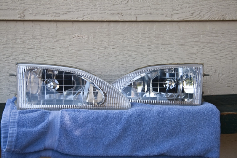

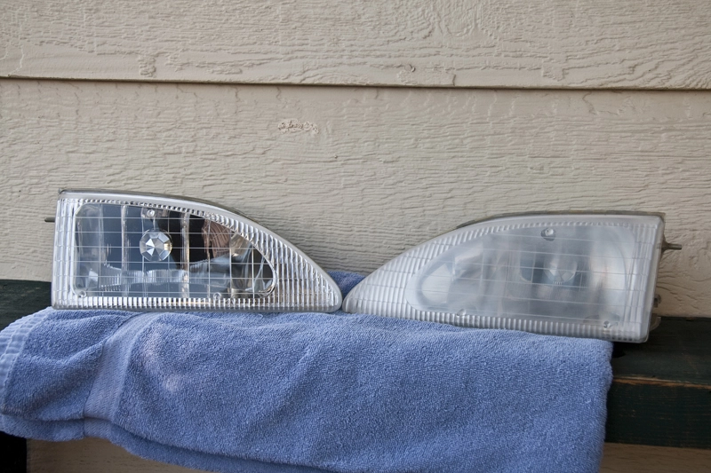

Left=Cobra, Right=GT/V6

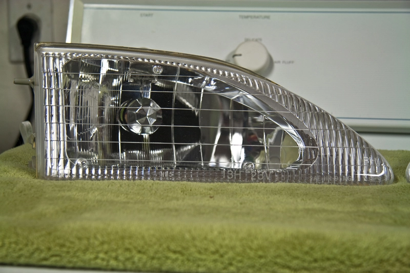

Headlight Assembled with HID Bulb for Check.
Got Those Adjusters In!!!

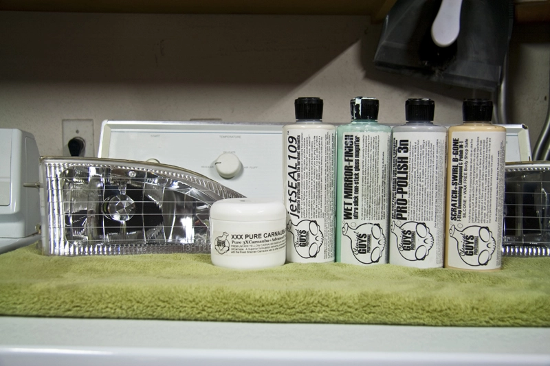

So Now to the Restoration Part!!!
Washed With CG MaxiSuds II and a Sponge
800 Grit
1000 Grit
1500 Grit
2000 Grit
CG Scratch + Swirl B-Gone w/ 4 inch Hex-Logic Orange Pad
CG Pro Polish 3n w/ 4 inch Hex-Logic Green Pad
CG Final Polish w/ 4 inch Hex-Logic White Pad
CG Wet Mirror Finish
CG Jetseal109 (2x)
CG XXX Paste Wax (2x)

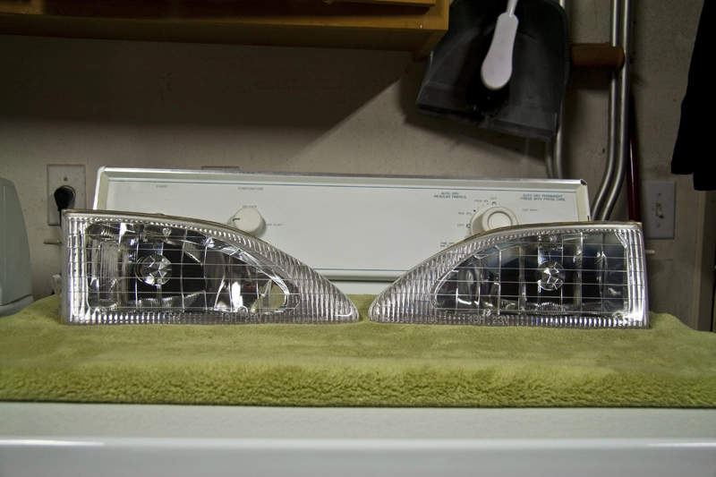

..... I think the pics speak for themselves!!!

Left=Finished, Right=Sanded
Perfection!!!! Brand New?

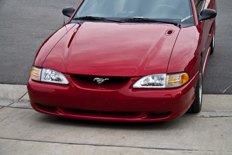

FINALLY, LOOKS AMAZING!!!
Fitment was DEAD ON, because they are OEM and i spend alot of time lining of the body lines. Looks like i spend $400 on lights that are discontinued!!!

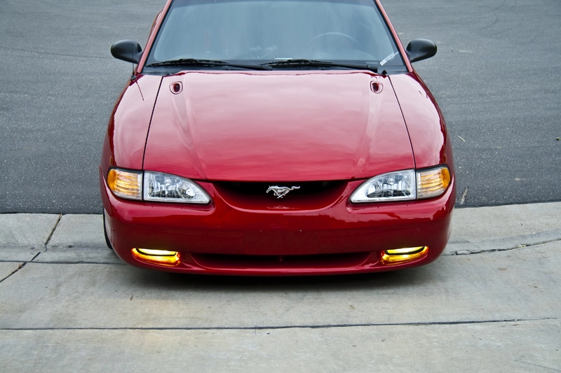

OEM Cobra Headlights w/ 6000K HIDs
OEM GT Fogs w/ Yellow Lamin-X + 3000K HIDs
