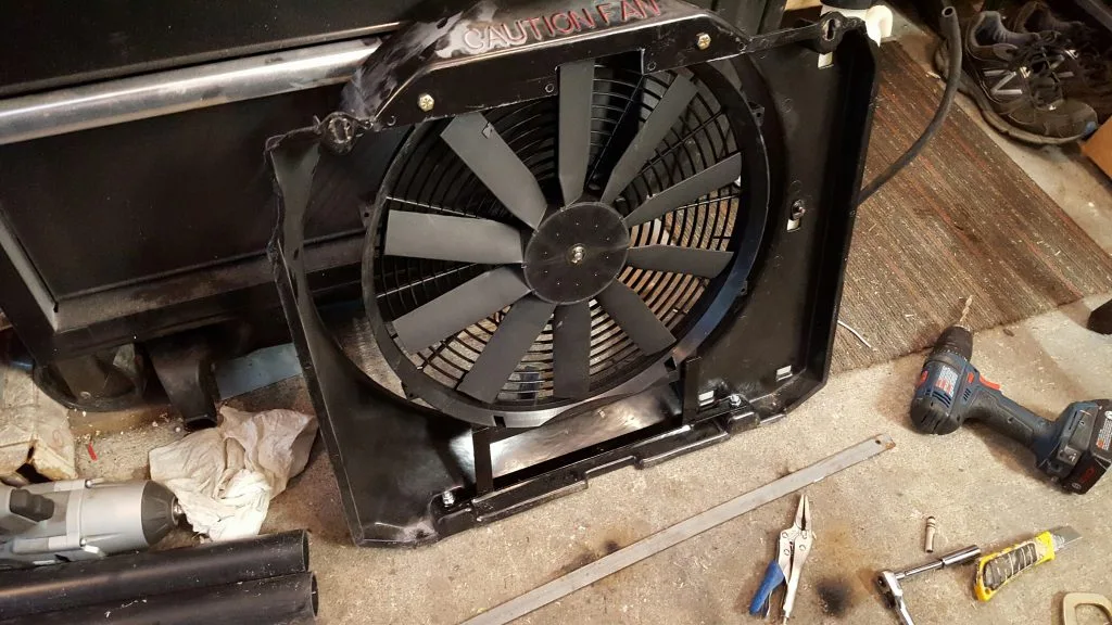

Damn. That bay makes me want to mount my efan inside my stock shroud and reinstall that. I'm liking the oem look.

A 2001 jeep Cherokee fan fits in the stock fan shroud nicely. I used to run one...just trimmed the jeep fan assembly to fit with minor mods. Worked great.
yeah it's pretty easy to make something work inside the shroud...
A closer look:
I didn't want to use those zip-ties to attach the fan to the rad.
A closer look:
Yup. I need to get on this. I need to find a different efan to use. But I'd love to put my stock shroud back in so I can run a factory coolant overflow bottle again.
Do you have any pictures of this setup? I have a contour fan on my car now, and they work great keeping my car cool, but they force me to run a chintzy parts store overflow. I wanted attach an aftermarket round catch can attached to the fan, but there is no room due the transmission cooler lines. The other issue I have is I have fairly thick aluminum radiator, and large single electric fans like the mark 7 won't fit as they are too deep and hit the water pump shaft.
I just upgraded to contour fans to save space. Finding overflows that fit is a biatch.
The Jeep fan set up worked and had clearance with the water pump....that was with a two row radiator...never tried with my three row.
I'll post a pic later....if I remember.
