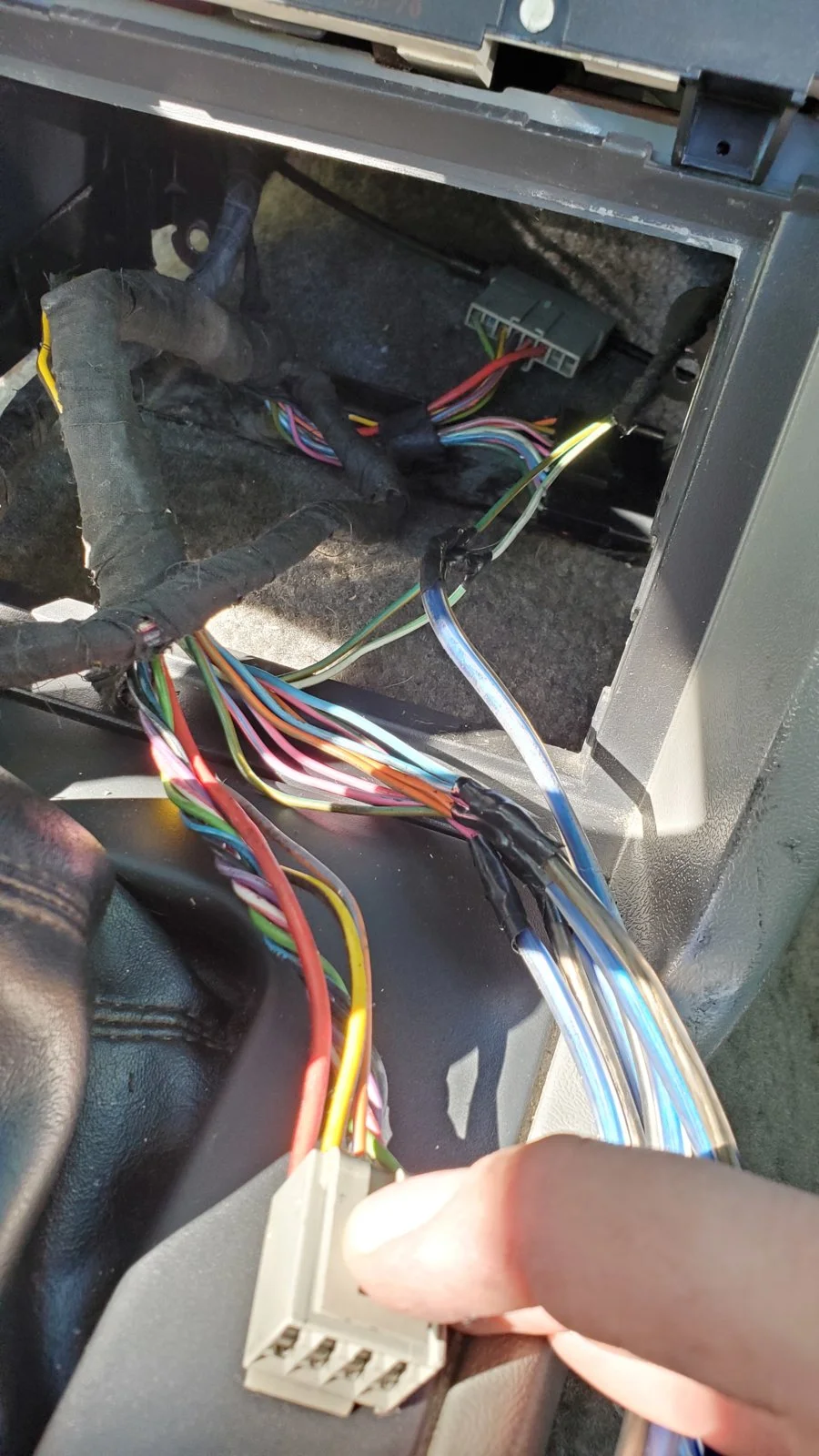

I went to reinstall the original radio on my 87 GT hatch. Upon doing so my fears were realized, the previous installer hacked up the original harness. My car originally came with the premium sound option. The original football amp is missing. They also installed new door speakers that it appears they ran new wire for and spliced into the post amp harness. I'm thinking if I can find the proper original style amp, and get another connector that is now missing that would go to the amp. Then I should be able to piece it back together?
You are correct. That's the amp harness in our hand. There are two connectors that connect to the amp. 2 that connect to the body harness, and 2 that connect to the radio.
The two female plugs in the background would connect to the body harness. That would leave two male plugs out of sight to the right that connect to the radio.
You should be able to remove the two wires going to the door speakers provided the door speakers are using OEM wiring. If not, you may need to connect the OEM wiring first.

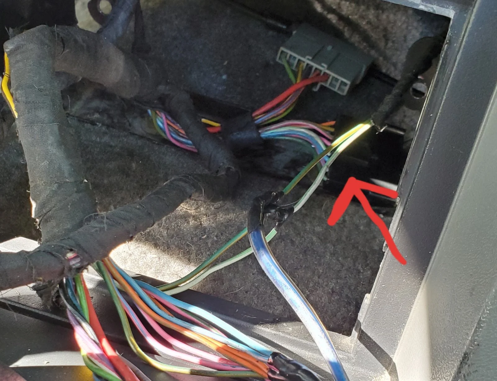

My assumption is that the wires from the door speakers are no longer tied into the car harness. I believe these two wires to be running to the door speakers, and look as if they just tied them into the matching wires on the amp harness. If that makes sense?
