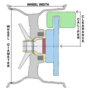

Once the width of the wheel and tire to be used has been determined the desired backspacing can easily be calculated as shown on the diagram.
Offset
Offset can be positive or negative and is measured from the centerline of the wheel to the wheel mounting face or pad where the wheel bolts to the hub flange of the vehicle.
Positive offset is when the wheel mounting face is outboard of the wheel centerline and is popular of front wheel drive / newer vehicles.
Negative offset is where the wheel mounting face is inboard of the wheel center line and is more common on rear wheel drive, older and classic cars and gives the “ sucked in” deep dish effect.
Offset
