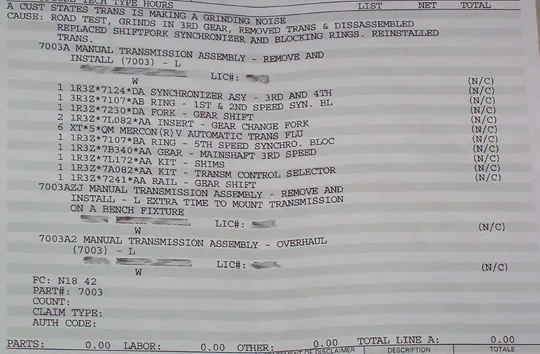

i finally got my car back today :nice: ...ford did a tranny overhaul so i have lots of new parts and THEY FEEL GREAT.....the only thing is i have to get the 2nd to the 3rd shift loosened(new, tight gate)...Either way, i am totally happy and glad that i was able to get my tranny fixed. i feel like i have a brand new car all over again :D I can shift into every gear now and i know that there wont be a grind. :D :D :D
I will post a pic of what they did later on(invoice).
Here's everything that was done :D

I have had the TSB done for over a year. I think I was the 3rd or 4th to get it done on this site. It is a major improvement, I'd say about 90% better. (One thing to note, I do not drive my car in the winter. First snow storm it goes in the garage until spring. So I don't have many cold weather miles.)
Thanks for the reply
Cold is a relative thing. I get the 1-2 grind when temps are below 50F. Now on those January mornings with 5F temps... :bang:
So from what you said the "fix" sounds like it is an improvement.
For those of you who are getting these repairs, are you removing your aftermarket shifter before going in? I'm just thinking of some pathetic reason they might have for the grinds.

i left my shifter on, but i made sure i asked the tech if they have a policy against them first....

i took mine in and showed the tech that my car would grind (i engaged the clutch and went from 2nd to 3rd quickly and it would grind)...they told me that they would fix it and they did. i never mentioned one word about a tsb and going by the posts i have read on here, the people who mentioned the tsb had a problem getting their car fixed
