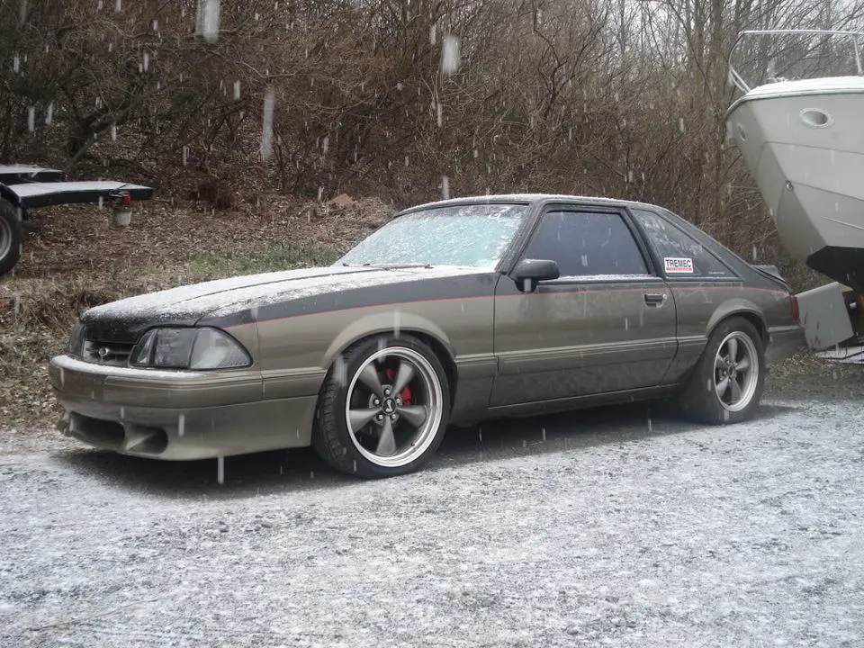

My only gripe with the ranger axles and the 17" Bullitts are how they sit in the wheel well... They tuck way under and to me that looks terrible. We have two fox's with these axles, and with any of the SN-95 offset wheels they have this tucked appearance. If you plan to run a 10 or 10.5 wheel out back, do the ranger stuff, if you plan to run a stock sized wheel, run the SN axles...

Not sure if the drums will work on those axles, my guess is no, but dont quote me...
A lot of people like the look, me personally I HATE it. I hate the tucked wheel look on Mustangs. I have 17x8s on my car now, with 26x10.5 ET Streets, and it looks goofy! You can "kind of" see it here, how the rear wheels are tucked. I have more clearance to the fender lip than the inner wheel well with this set up!
