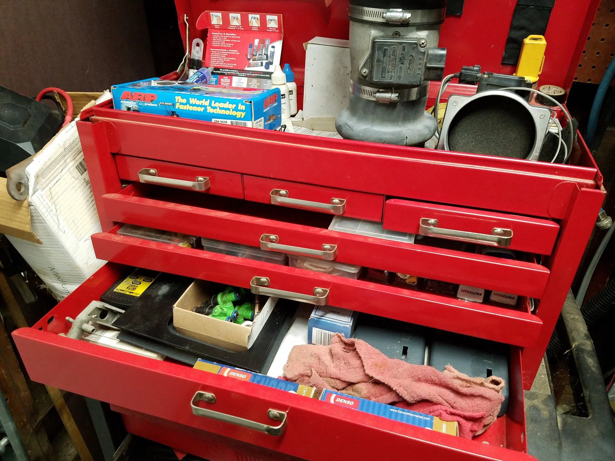

I have a hankerin' to play Where's Waldo....
Good tip though. They're cheap as hell and PERFECT for a Fox (or any other Ford OBD1 car).
It is also the same unit listed in jrichker's checklist.

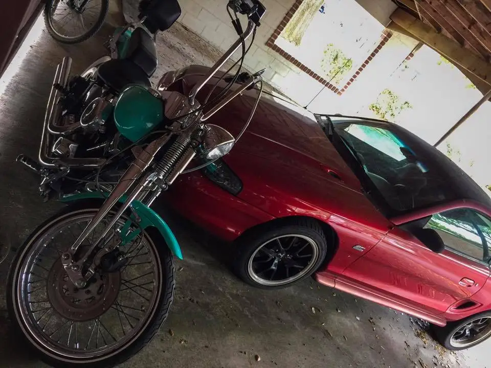

Is that a shovel head?
Can't tell from the pic
I got a 82 fxrs

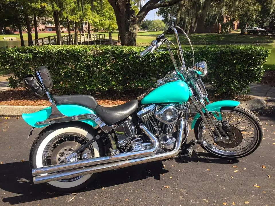

A little newer, a '97 Blockhead. I just finished getting her all back together in November after I wrapped her up pretty bad about 3 years ago. Almost lost a leg and had to relearn how to walk. You know, that old chestnut. Here's a better pic:
And my favorite pic:

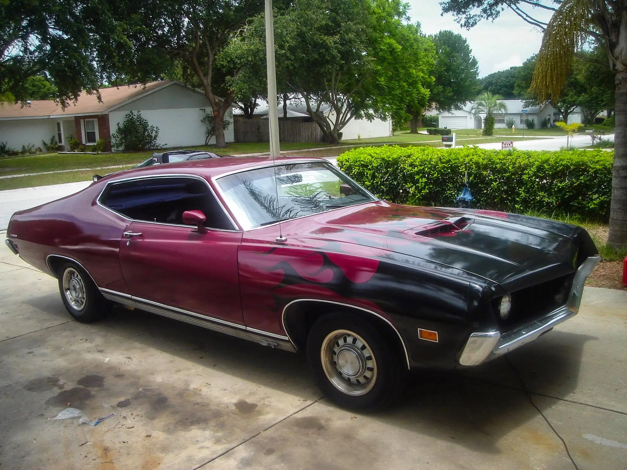

Are all your toys just badass?

I've had some cool stuff over the years! I'll trickle some pictures in periodically. LOL!
But I sold that Torino back in 2006. A friend of mine gave it to me, literally gave it to me for free, because he was moving out of state. It hadn't run in 5 years and wouldn't start, so I gladly paid for a tow to get it to my house. It ended up needing a new wire from the battery to the starter relay and a right side exhaust manifold. Got 'em in there and it fired up on 5 year old gas! He just move back into town, and I still owe him for that car. I'm going to take him and his wife out to the best steakhouse in town.
