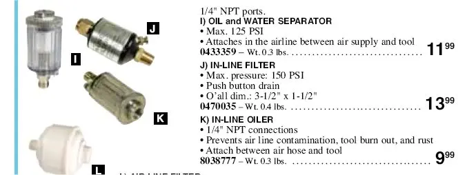

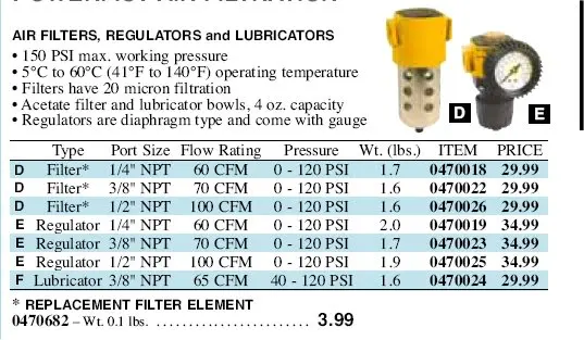

here is what i think i am gonna do
don't know how i am gonna put baffles in the vlave cover sooooo i am gonna use this its only $12 so i may as well give it a shot i will try this one inbetween the valve cover and TB on that line, the demensions are preety small so i can kinda hide it too (item I or J i'm gonna look at them tommorow and decide)
and this is the one i am gonna get for the larger line at the firewall
looks ok? obviously gonna paint it black

so where are you guys putting these filters, i am gonan do it after work tommorow
it goes on the line that goes from the pvc at the BACK of the lower intake to the upper intake? and where exactly are you mounting these things? i tried pictureing it but i can't see where to put it. pics would help
