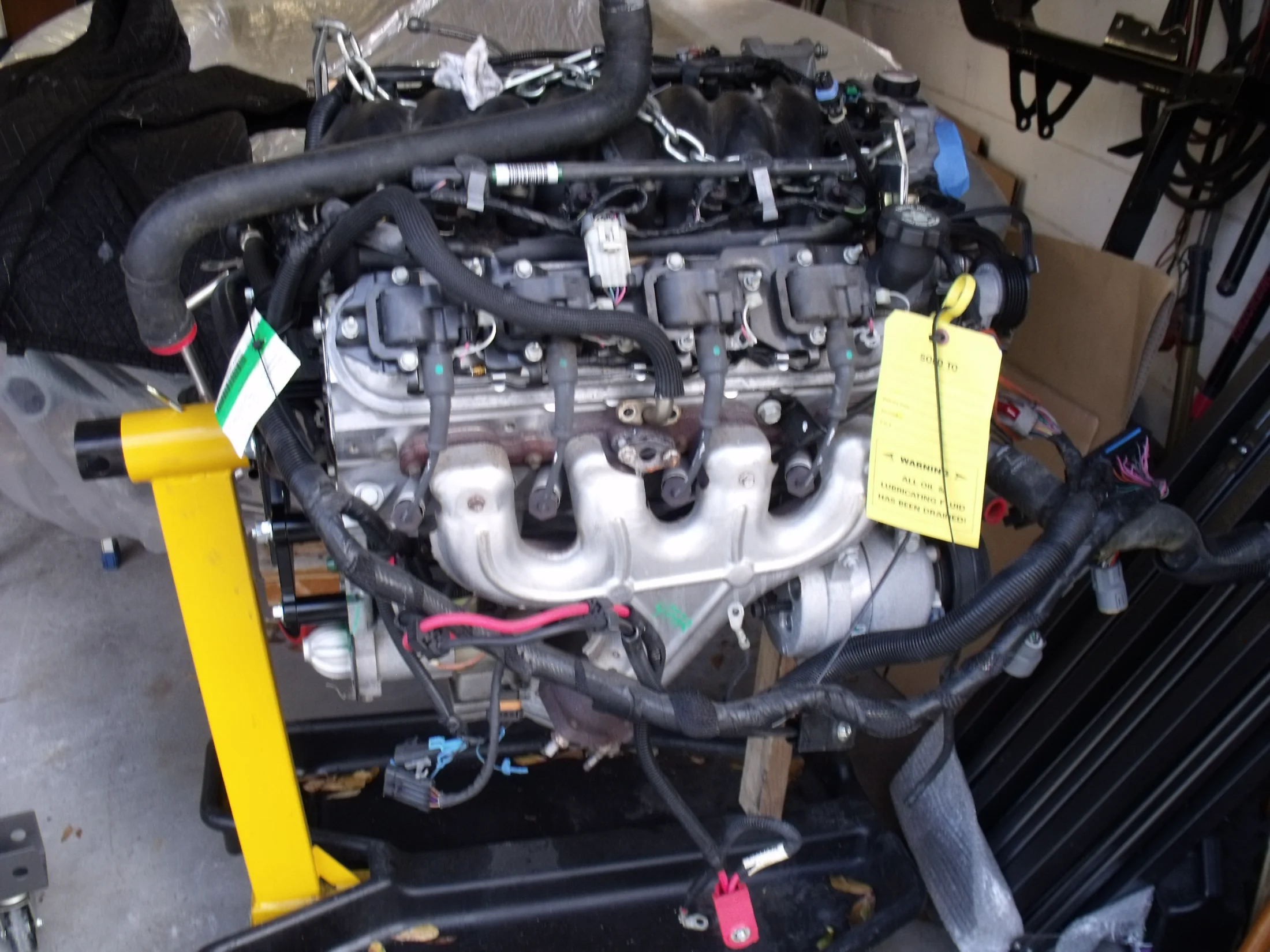

Any brand new cars I run for 1000 miles and change the oil.. Good idea to change the transmission, rear ends and transfer case at the same time, as all are new and have break in metals in them....
ALL rebuilt engines have dirt in them and I change mine at 100 miles...
As said above 10-30 is probably a safe bet..
Never a believer in Amsoil until I used it in my Harley... It runs quieter... I have had good luck with VR-1....... Is Penn oil the green stuff?? I like it too..
Newer cars using the 0-20 oils I still think are used for better mileage results... I just switched my Duramax 3 liter diesel to 5-30.. Eff em....
The strength of synthetic oils is its resistance to heat.. I use it in any air cooled motor I have... My Harley, my WAY over priced ( John Deere) mower, my generator ( florida hurricanes) .... In my opinion, water cooled engines really don't need synthetic oil, but I do run it in some of them...

Glad I am not the only traitor on here..... My LS1 will be going in my " other project" which is a chevy...
