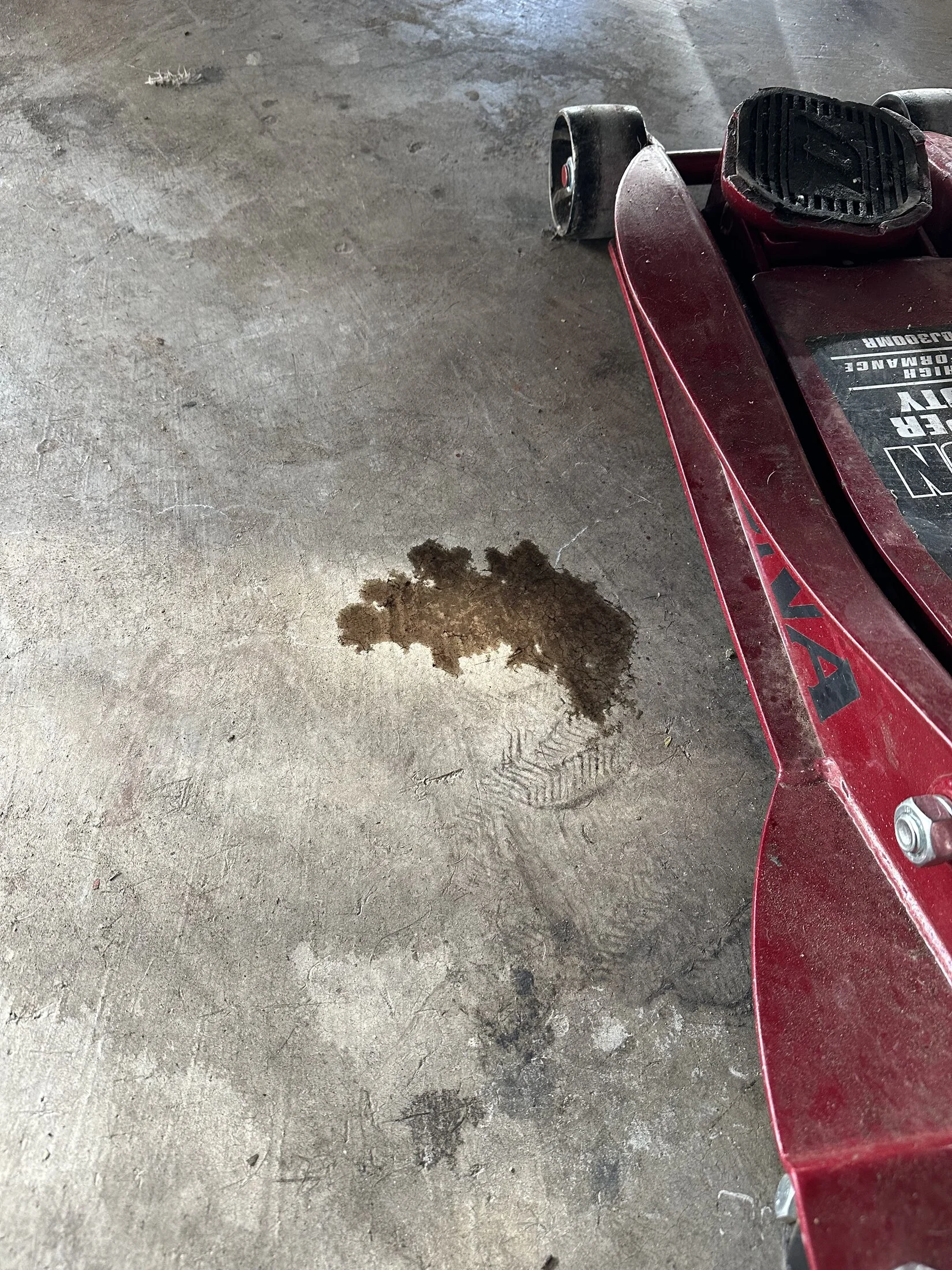

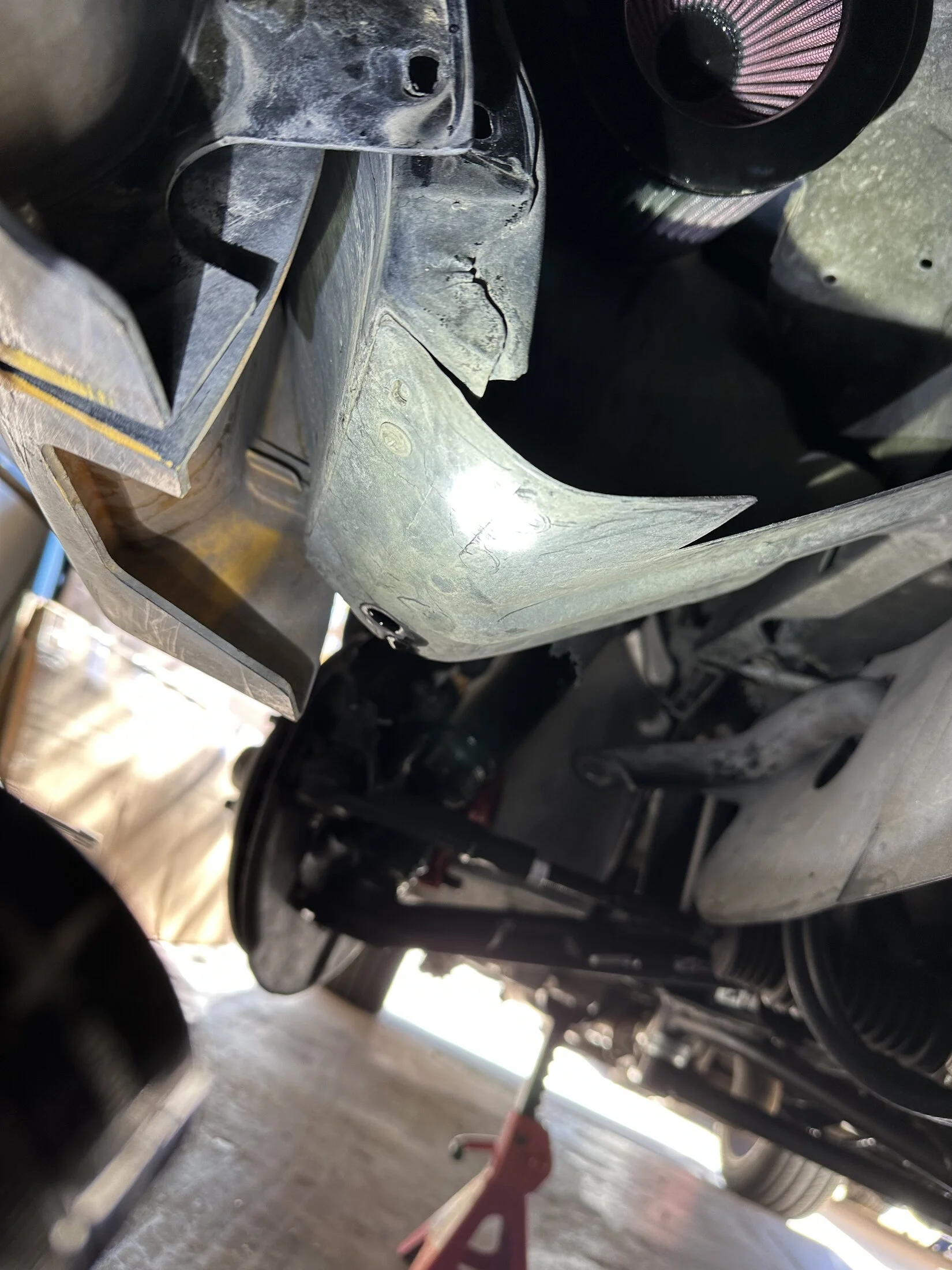

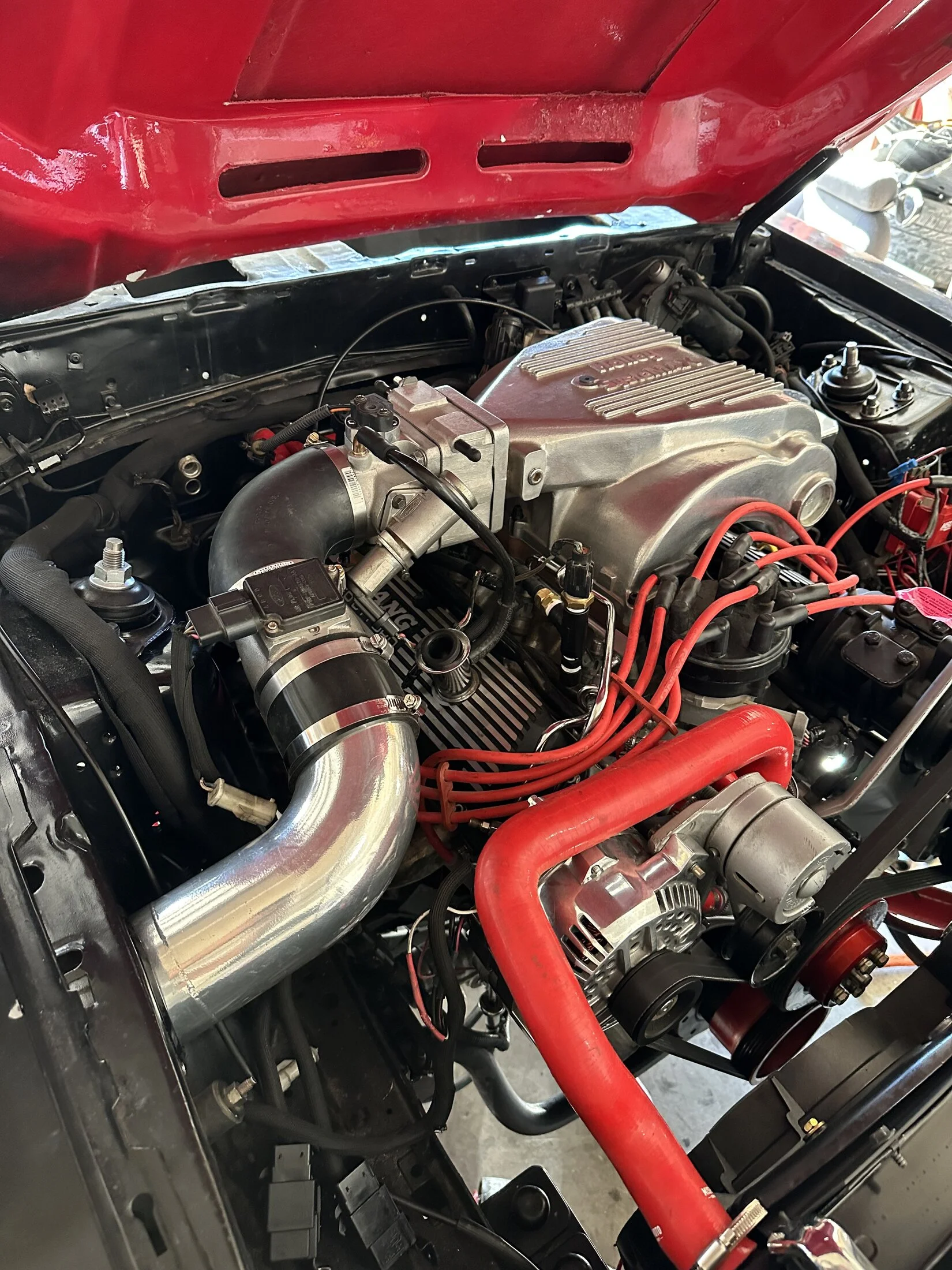

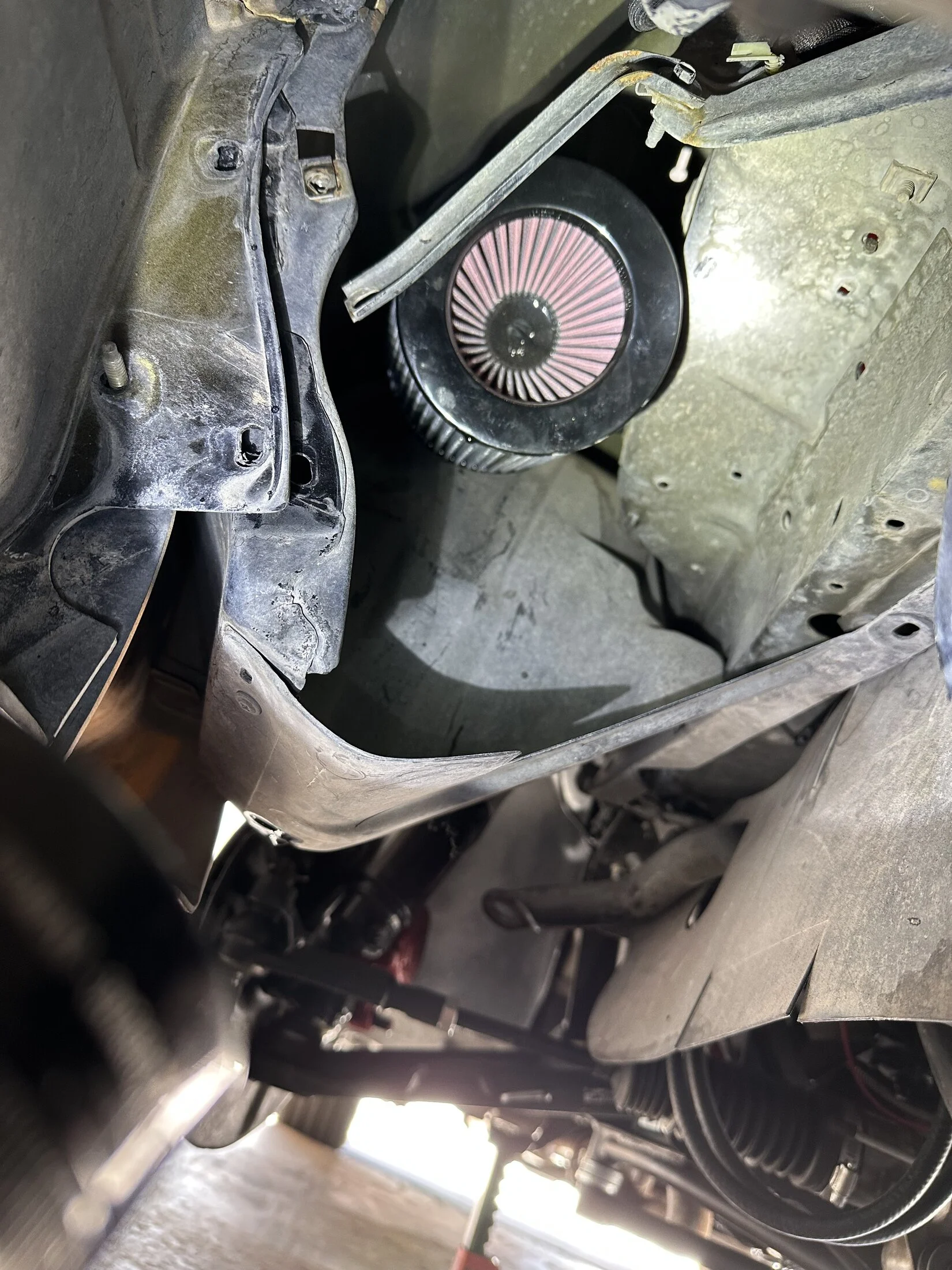

Car runs great but after I drive it a while I noticed oil dripping from the passenger fender. Checked it out and noticed my air filter was full of oil. I have the pvc connected to the manifold with a t fitting going to the intake manifold and the vacuum tree. Engine only has a few thousand miles on it. Maybe 5k. Is there anything else I can do to help this issue. I’m sure it’s not supposed to do that. I can provide more pics and more info if needed.

Have you pulled the intake tubing off to see if any oil present in the intake track and/or MAF? I would imagine the oil is leaking down from the throttle body after you turn the engine off
I did have to pull off the upper manifold a couple days ago but didn’t run it long prior to that. There was some oils in the throttle body and a little in the manifold where it meets the throttle body.

I just re routed my vacuum lines. Thinking of buying the tree that goes under the manifold. I have everything hooked up to the throttle body or the nipples on the manifold closest to throttle body.

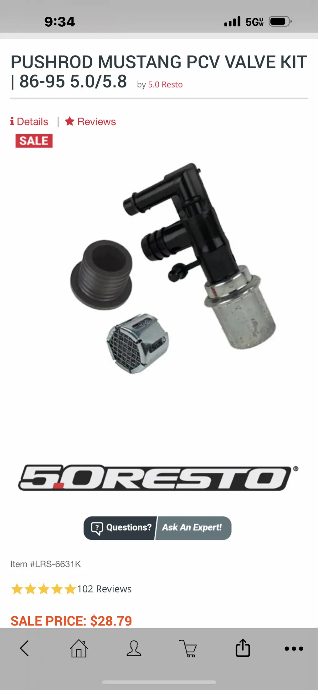

I’ll do a leak down test next. I’m wondering if I have the pcv valve routed right it just says to manifold. I’m missing the tree under my manifold going to buy that and move the vacuum from the throttle body are on the manifold to under the. Manifold to that main tree. Also I saw a picture of a pcv valve on LMR and it had like two outlets? Where does the 2nd one route to?
One size fits all, just get one from the corner auto parts store, you'll get the same thing for less money, common part made the same for like 60 years.
Ok thanks. I have one from Autozone didn’t know if the 2 nozzles on the one from LMR would make a difference or if there was another hose I was missing. Still getting oil in my filter from the cai. Not 100 percent where it’s coming from I checked all the hoses and they looked dry. Where are the possible locations the oil can be coming from so I can check
