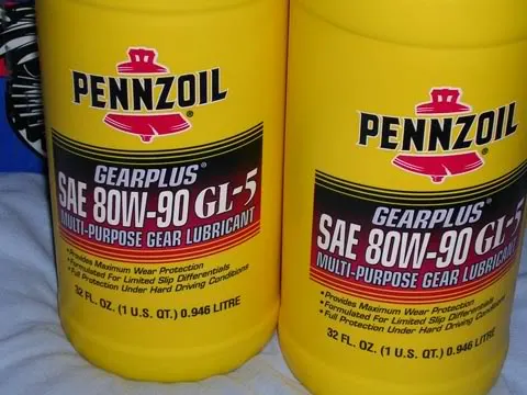

Well I'm doing a gear swap too. I have a bottle of friction modifier and this oil
Am I going to be ok using these 2 things? I was also told that our differentials require synthetic oil..
