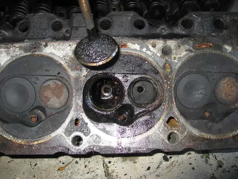

oil is from head.
Popped out the pistons today. The rings on the offending cylinder were intact and the bore is smooth. I decided to investigate the head and removed the valves. It looks like the oil is entering through the intake valve. Possibly the valve guide but since I'm not reusing the heads I'm not going to investigate further.
