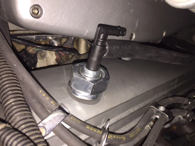

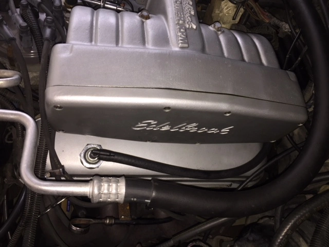

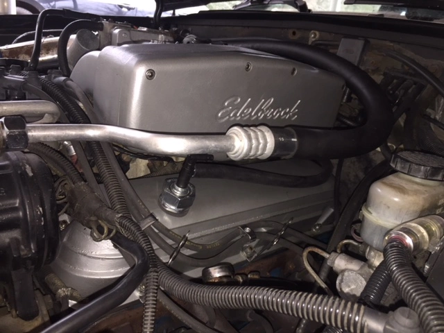

Went ahead and drilled into my driver side valve cover over the weekend. Installed some sort of pressure fitting (Home Depot) that screwed into the hole I cut, stuck in a PCV grommet, and a PCV valve. See attached pics. I first tried a T set up, connecting the PCV behind the intake and the new PCV on the valve cover to the manifold vacuum. Still smoked and had a lot of oil in the intake and coming out of the exhaust; I'd say it was less than before but still way too much. Plugged the PCV behind the intake and ran the new PCV straight to the intake vacuum - no more smoke or oil coming out of the exhaust. I only drove it a short distance but no smoking at any point driving, idling, or revving. I haven't opened the intake plenum yet but don't expect to see any oil now. Also need to see how the plugs are looking and run some other tests to see if this will fix the problem, at least for now.
I still think the lack of an oil baffle is a major factor in the oil coming from the stock location. Plan is to buy/build a baffle and see I can reactivate the stock location and possibly run both PCVs together.
I'll put more miles on it and reply back with updates. Thanks for your comments.
