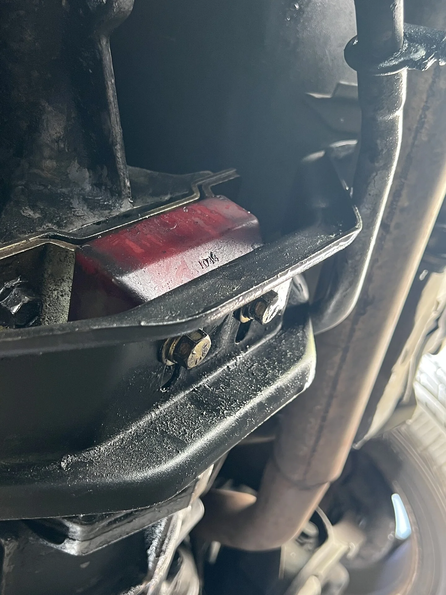

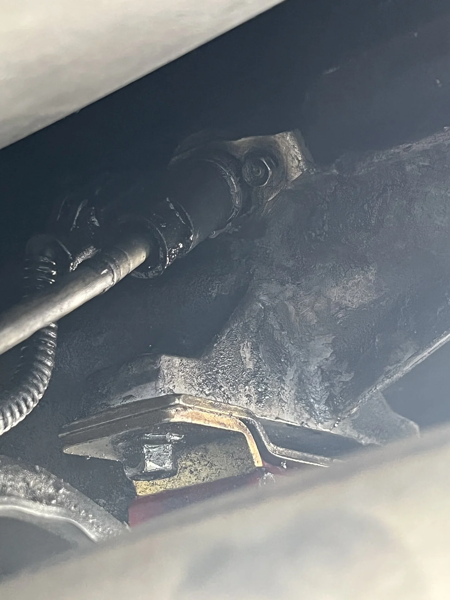

Starting to think it’s not engine oil but the speedo cable
I think so as well.
Spray engine degreaser and hose that down. The VSS has an o-ring, but I’ve found speedo cables themselves leak at the crimp. A good price of marine heat shrink will fix that.

Just degreased it and hoses it down
And yes the transmission is whining.
When I did the clutch I also changed the transmission fluid and when I did hardly nothing came out
