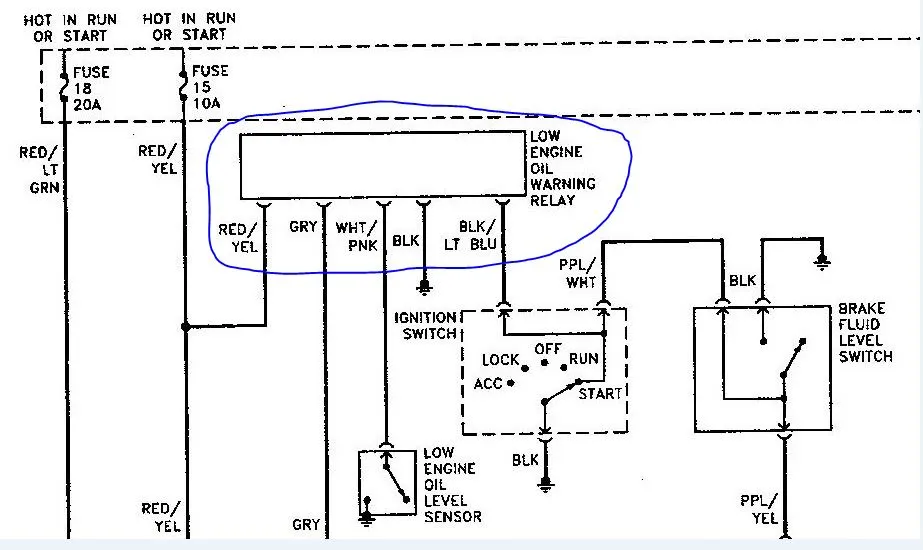

It's most likely something messed up in the wiring. An open circuit should be oil norm. If you unplug the sensor, the light should go out. If it doesn't go out, there is something wrong in the wiring.

Where is the Low Engine Oil Warning Relay? According to this diagram from my Haynes Manual there is one. See attachment.
