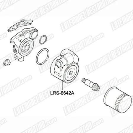

I had the same problem a few years ago. It ended up being the oil filter threaded piece wasn't fully tightened down. When you remove the oil filter, there is a center threaded piece sticking out about an inch or so that the filter actually threads on-to. On the end of this threaded piece, there is a depression for a 1/2" Allen wrench.
Here is a picture of that piece (it's between the oil filter and the oil cooler)
First I'd try tightening that down. It could cause a small enough leak that would likely look similar to your pictures.
If that doesn't fix your problem, look over the oil cooler (third piece from the right in the picture above). The oil cooler has a tiny pin hole facing down towards the ground. This allows oil to leak if/when the cooler fails. If you have oil draining from the pin hole, it's time to replace the cooler (it's an expensive piece... about $350 from the dealership or LMR).
Finally if that isn't the problem, it could be leaking from the crank or the oil pan. Both of which will be expensive to fix if you're not comfortable doing the repair yourself.
