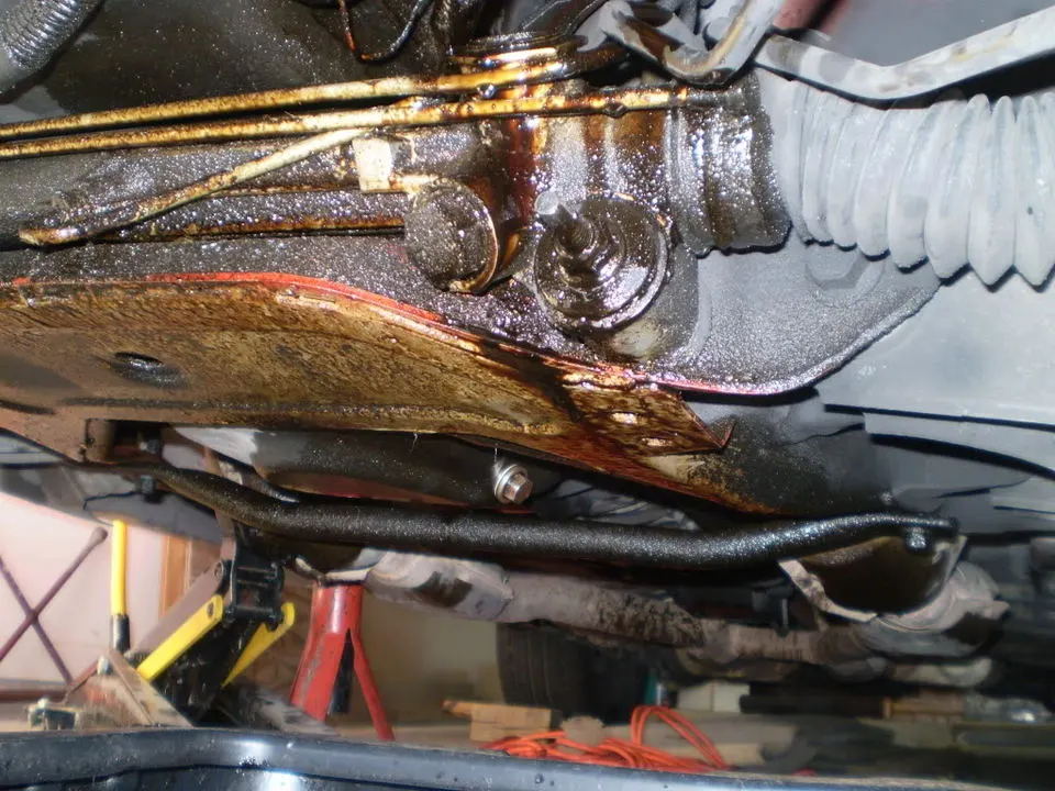

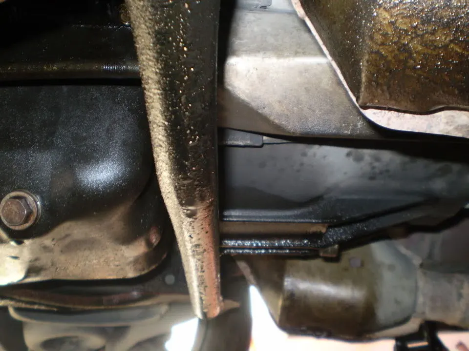

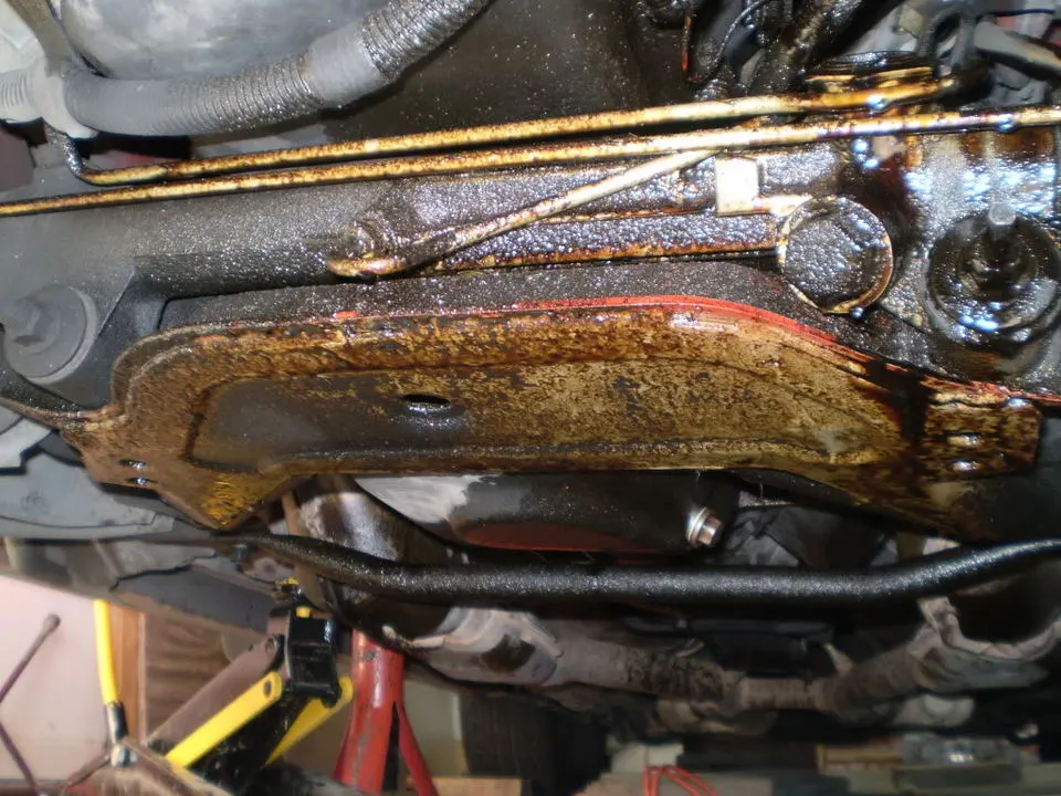

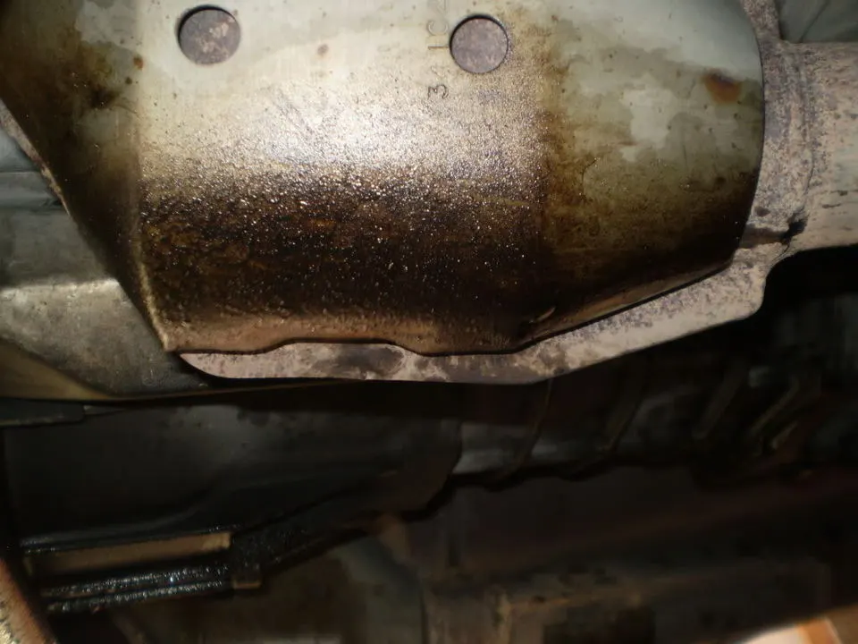

First off, what in the world was ford thinking in their placement of the oil filter on the 4.6? It just spills oil all over the steering rack, etc when you replace it. Anyway, there is oil all over the underside of my engine and I can't figure out the source of it. Its possible its from oil changes and not getting cleaned up and then getting thrown all over the place by the moving parts but I'm suspicious that its something else. Below are some pics of what it looks like, anyone got any ideas on what to check out? I was thinking perhaps its transmission fluid because its on the bottom of the transmission as well, but I don't know how to check the transmission fluid level on this car. As far as I know the engine does not leak motor oil, at least not at any concerning speed. I've noticed oil drops on the ground from my car but I'm not sure if thats just from the residual oil all over the bottom or if its actually leaking from somewhere.

I can't see it being transmission fluid as it wouldn't be on the rack crossmember, but it looks like the front seal and or possible the rack is leaking fluid i do my own oil changes and never get that much residue left over. and with oil on the ground means it is leaking from somewhere just the color of oil could help out trans oil = red motor oil = clear/black p/s = red or at least it used to but i would locate where the oil is coming into contact with the heatshield on the cats as it is a potential fire hazard *IMHO*
that would be smart, also after doing that check the oil filter to make sure its sealed up, also the cam cover and oil pan gaskets as possible areas to leak. If the car has underdrive pulleys check around the crank pulley. I don't think its your power steering because after leaking that much it would begin to whine during turning and braking. And for future reference to check the tranny fluid on a manual trans, there is a plug on the side of the trans that you screw out and you just stick your finger in it. If it comes out dry it needs fluid.

Look at all the oil running down the side of the pan. It either leaking from the oil filter, front crank snout, or oil pan gasket. The leak will be easy to spot after a good cleaning.

I'd clean that all up and then do periodic checks and see where it's coming from. It kinda looks like your rack is leaking...or the filter is pissing oil out.

I had this exact problem a few days ago. Noticed alot of oil in the EXACT spots you have. Crawled under there and found it was coming from the oil filter. I cleaned it all up, replaced the oil filter gasket and tightened it back down. Good to go. 10 dollar fix.
It could also be the dreaded doubled up oil filter gaskets. This happens when the gasket from the old filter sticks to the engine and then you screw the new filter on and have two gaskets which creates a significant leak.
