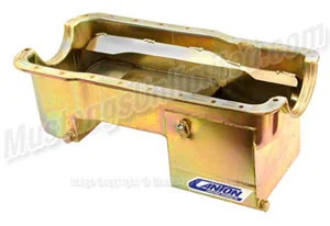

W wmorris132 New Member Oct 9, 2006 13 0 1 Apr 7, 2009 #1 Apr 7, 2009 #1 My engine builder (Jim at Fordstrokers) said I should get a 7 qt pan. What one fits our cars the best? I have the stock k member and will have longtubes. Thanks.

RIO5.0 15 Year Member Feb 16, 2001 6,892 8 128 N.H. Apr 7, 2009 #2 Apr 7, 2009 #2 Most common is Canton.... This will clear the k member and steering rack.. some say the 7 qt pan arent really needed and spend the money elsewhere..

ProKiller Founding Member Apr 26, 2002 3,064 15 78 PA Apr 8, 2009 #3 Apr 8, 2009 #3 i run the 7-qt. dss pan with the stock k-member and long tubes, no problems.
