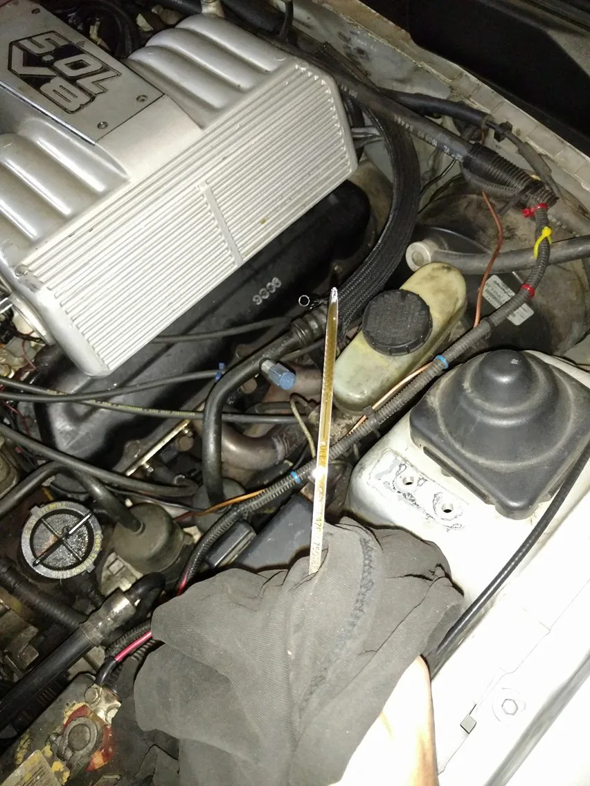

Edit: This is coffee color right?

A little tough to tell from the picture but it looks milky. Be especially suspicious if the oil level is higher than when you last checked. Open the drain plug and you'll know right away, the coolant settles beneath the oil. Which is why I suggest not driving it (even a test drive -- or even starting it) -- you'll be pumping pure coolant as lubrication since the pickup is at the bottom of the pan, and you can wipe the bearings in seconds.
An easy way is to pull dipstick, put a little oil on exhaust manifold when warm, it will steam if theirs water content in oil. You said you installed new/ used heads. Pull the heads, send them to a machine shop that can pressure test for cracks on aluminum heads. It sounds like you have a cracked head, or installed a head gasket improper. When you pull apart motor, inspect cylinder walls for cracks, inspect each combustion chamber on each head. One of the combustion chambers could have a small hole or crack in it. Sorry pal, but it's tear down time.
