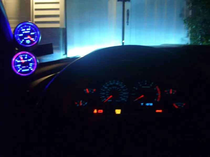

I had the same issue installing the blower. I tried to do a T to a Y to fit THREE (line to the blower, adapter for stock guage and adapter for autometer guage).
To make a long story short, after about 2 hours of tryinig every combo, every twist and turn, we just said "F THIS" and just kept the stock guages unplugged. LOL!
OH NOEZ! NO OIL PRESSURE! ;)
POS only reads 0-6 psi anyway...
Could Ford get any cheaper? honestly lol...
