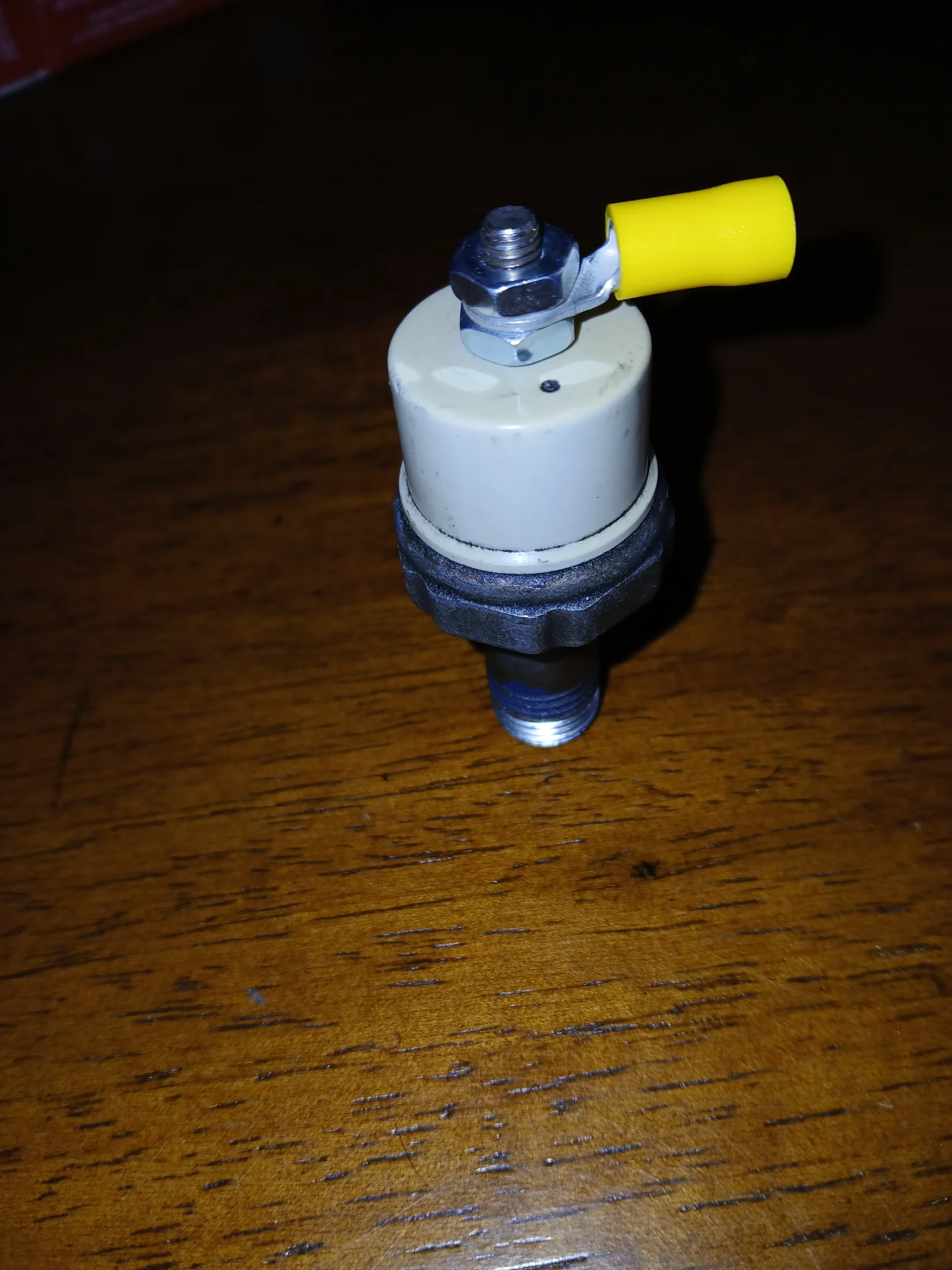

Are your washers, lock washer and ring terminal brass?
I have a steel ring terminal, 2- steel nuts. I have 2 brass nuts I can use also.
I believe the connection on the sending unit is brass?
Not sure if it's wrong mixing dissimilar metals?
Thanks!
This is what I have so far. I'm going to add the washers and lock washer.
I cut the one off the factory harness years ago. Crimped a ring terminal on the wire, put a flat washer on the sending unit, ring terminal, flat washer, lock washer, and then a brass nut. Never had an issue.
This except I use a ring terminal for the auto meter electric then the factory connector on top ofit if I want that to work, sending unit ohm range is the same for the canister style and 2241 autometer uses with the short sweep gauges.

You might be able to give the LMR connector a squeeze in the right spot to help it grip better
Yes, I tried that a bunch of times, but it kept coming off after a while.
The problem with the LMR connector is that is too small. When you finally get it on, its already out of shape and won't stay on.
I was going to try this one to if it was any better. https://www.npdlink.com/product/repair-harness-oil-pressure-sending-unit-repro/201582
But now I'm going with the ring terminal set up. At least it will stay on.
