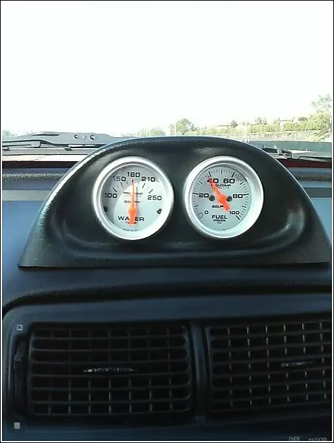

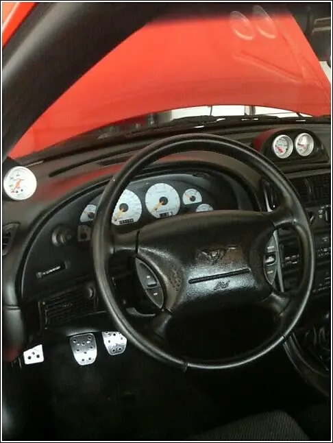

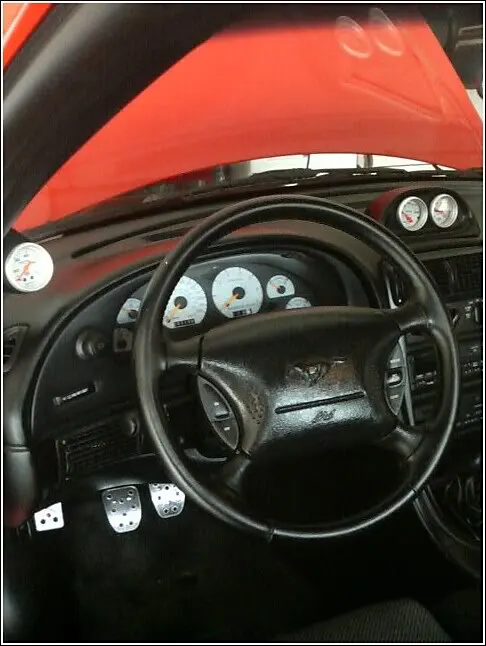

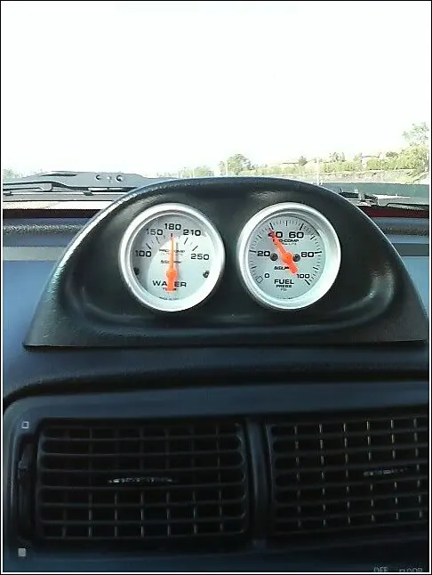

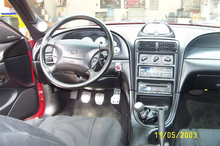

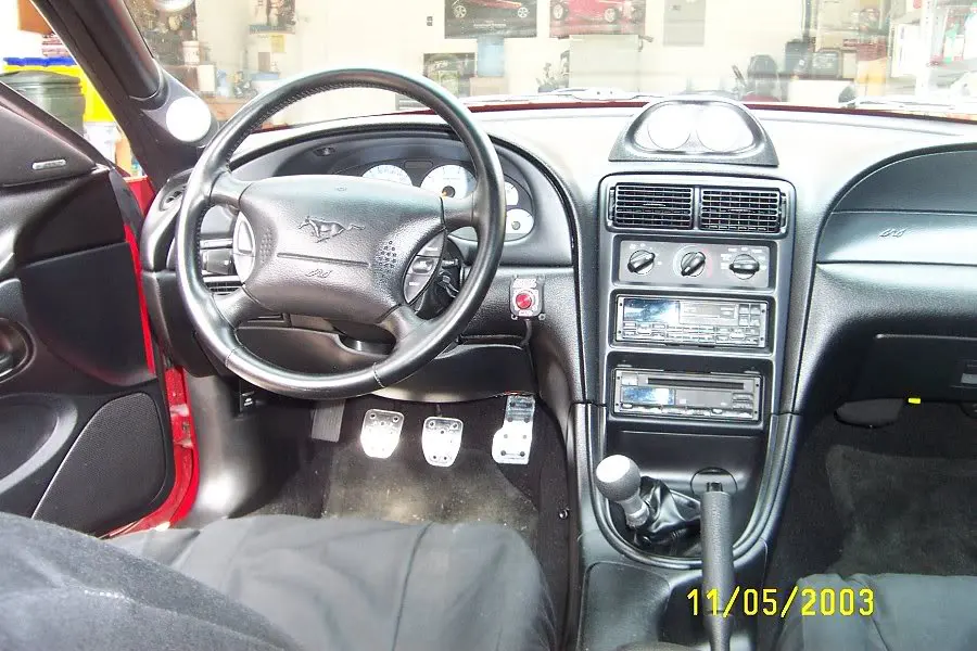

Time to put real gauges on the car. I went with Auto Meter mechanical Fuel Pressure, Water Temp, Oil Pressure and Boost (when I had the blower). Removed the Boost and replaced with Oil on the A-Pillar.
With the Supercharger, car was rarely dirty but it was this day.
