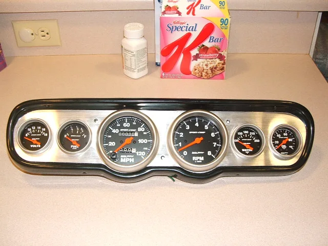

I used autometer sport comp and ABS gauge bezel in my 65 fastback. just my low buck way of making things work.:D
Parts list for me too please
I purchased a dash and gauges from Haneline for my 66 coupe, and it is the most worthless setup I ever wasted money on.
The new dash mount is flimsy plastic, the gauges are too deep to clear the dash braces, so the gauges wont sit into the dash properly.
At any rate, turned out to be a waste of $500 in my opinion.
If you could send me your parts list as well, I'd be appreciative.
That does look dam good. I bought the Haneline as well for my 65. I have it all in and its working well, though I do have a speedo problem with my cable. My one complaint is that the gauge panel was VERY FLISMY...heck without that metal part, I think it would have fell apart. Also I do not care much with their numbering system, and the instructions were faded and sucked, but overall its does not look so bad, and ANYTHING is better than the idiot dash.
In retrospec, I should have found a cluster panel that fitted my 65, and built my own gauges. But oh well.
Isaiah’s Gauge Project:
The project is very basic and requires skill knowledge of a “6” on a 1 to 10 scale. This just a quick write up I did on break this morning...
Parts List
1. ATM – 3315 Fuel Level Ford/Mopar
2. ATM – 3321 Oil Pressure 0 -100
3. ATM – 3337 Water Temp
4. ATM – 3391 Volts
5. ATM – 3991 Sport Comp Electric Tach
6. ATM – 3992 Sport Comp Mechanical Speedo
7. ABS Gauge Bezel
8. Gauge Wiring Harness
Vendor: http://www.summitracing.com/ - Auto Meter Gauges
Options for Gauge Pod
Option 1: You can use the original gauge bezel with a gauge holder.
Vendor for gauges holder is:
http://www.dallasmustang.com/page/products.php?category=&group=&family=&product=61560
Option 2: This is the option I chose. I got the gauge bezel from: http://www.deltabaymustang.com/absinstpnl.htm
Wiring Harness:
If you want to keep your under-dash area organized or you think that you need to remove gauges from time to time then you need to install our universal gauge harness. It will connect all major brand gauges including Auto Meter and VDO and works with most dash layouts and sizes.
PWI30301 - Gauge Harness (Cable-driven Speedometers) http://www.streetrodstuff.com/Products/755/
Summit Racing also carries this part: PRF-30301 http://www.summitracing.com/
You do not have to use the harness if you prefer to just buy wire and make your own connections. I just prefer the ability to be able to remove the gauges without cutting etc…
I hope this helps… Please feel free to add info so we can hep out the next person who does this project.
