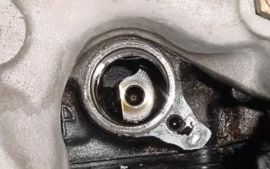

what drives your oil pump? Or to put it another way, to what does the oil pump drive shaft attach? I am getting a Moroso 7 qt oil pan and windage tray and figured while I am at it, I might as well get a new oil pump (standard vol) and driveshaft. Where I am confused is that I just got a new distributor and was told that I did not need a new oil pump drive shaft because my distributor was new. However, I thought that the distributor connects to the camshaft via the distributor gear and I cannot understand how the oil pump connects to the camshaft/distributor. Can somebody please 'splain this to a dumb ass lke me?
Here's a pic of the top of the oil pump drive (barely visible) in the bottom of the Distributor Hole.

I'll be the fourth, and confirm your distributor gear / cam drive metallurgy... if you have a roller cam you need a bronze/brass distributor gear.
Also wise to check the wear on the gear after a short time to make sure all is well after a few miles. A friend of mine went through all kinds of problems with distributor gears / pump driveshafts.
Buy the ford racing/motorsport oil pump driveshaft, it's worth it.
