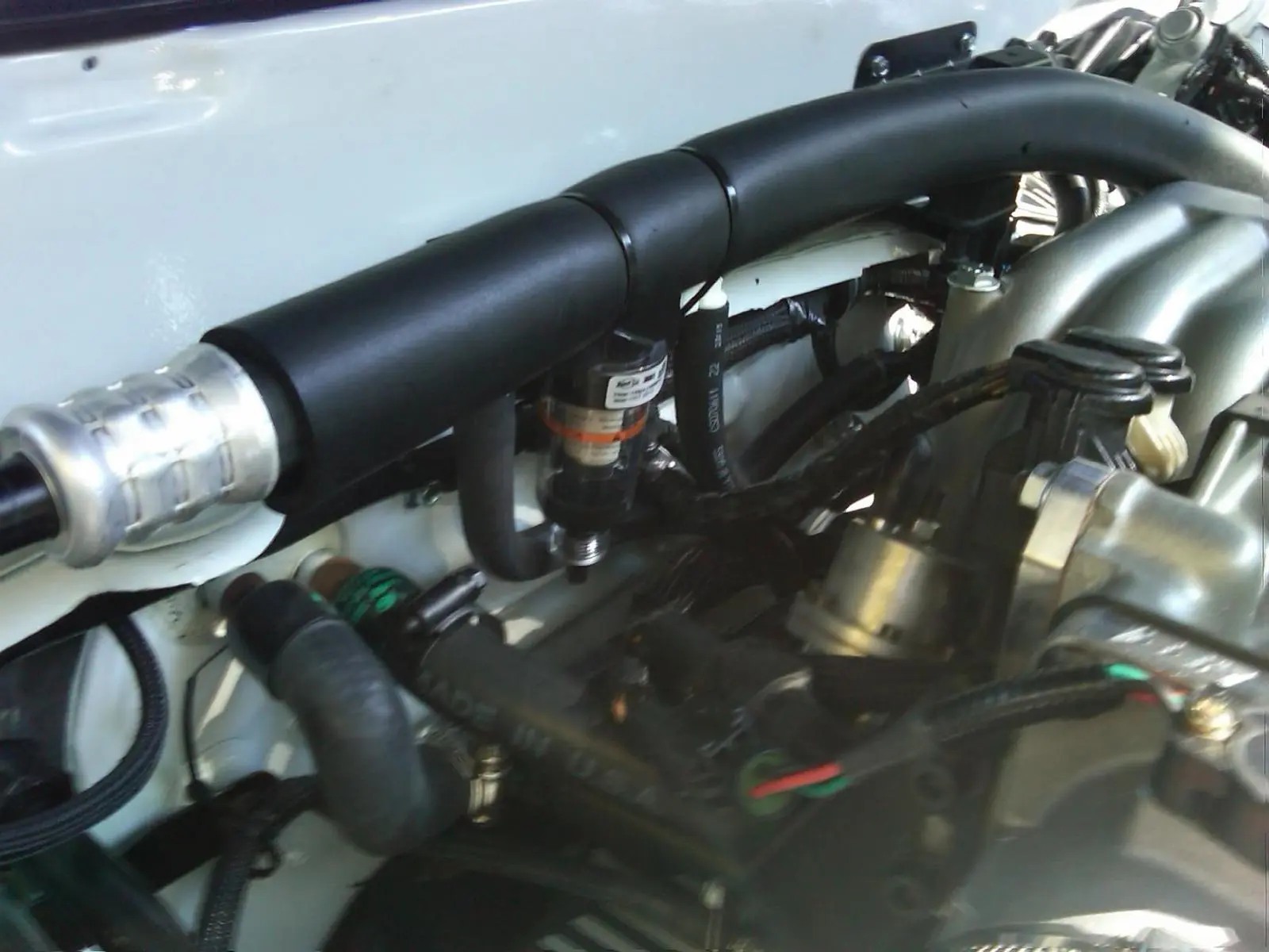

Well, here is the seperator after taking an aggressive ride on some twisty backroads. About 10 miles...
i think i am going to track down the larger baffle as well. This was also with the oil cap on, not the breather.
no smoke at all. runs great.

Well, until I locate a baffle for the lower intake, I am going to add another pcv valve on the pass. side vc.
