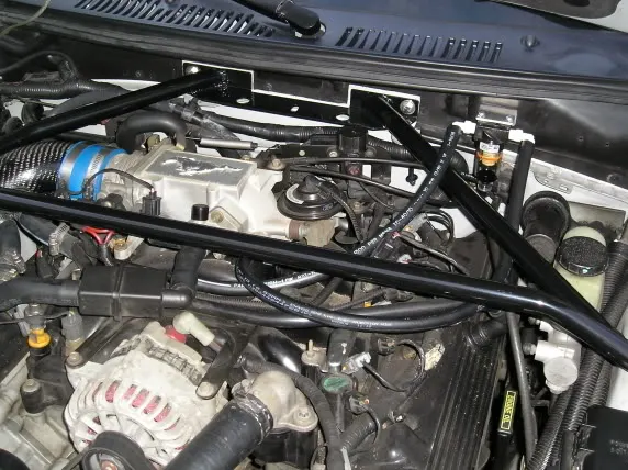

I searched but couldn't find pics for any GT's, just Cobras. I just made and installed an oil seperator kit on my 94, and with the benefits I've seen, my buddy wants to do one on his. He has a 2000 GT, but he doesn't know where or how to install it. I'm not familiar with 4.6's, so could somebody post a pic or two of their oil seperator on a 2V 4.6 (preferably 99+)?

Here's my setup. A few brass fittings, 2 pieces of hose, and a $10 dollar water separator.I've had it on or months and it works great. The inside of the plenum is nice and dry. In total this probably cost me about $16
I got the seperator from Lowes and it fits perfectly right behind the alternator, and the schrader valve that sticks out of the bottom tucks right into the void in the intake.
