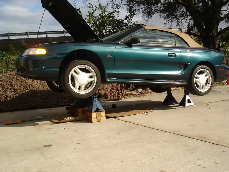

yes it will get stuck, and I dont think they make a jack to get under 2.5" under the xbrace you can use it to jack it up and lower it, I ve done it a couple times when I had to get the car 3ft off the ground.

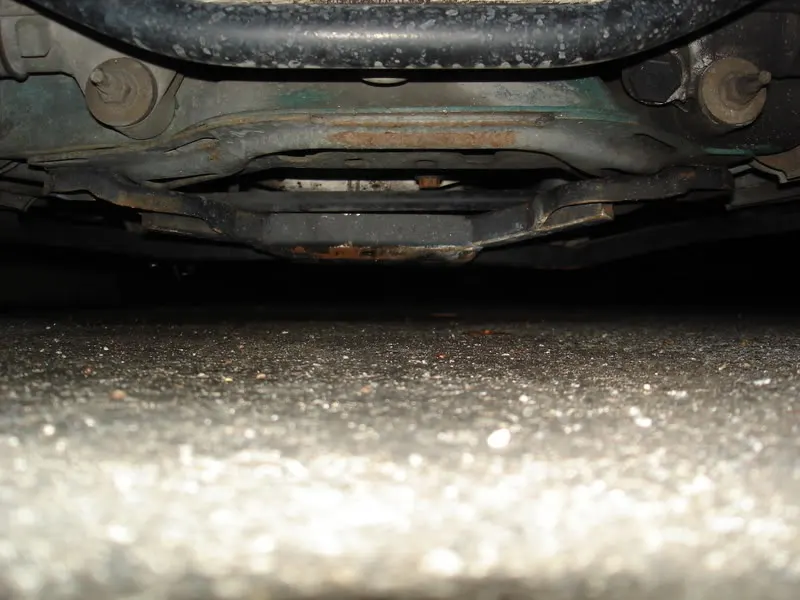

And heres how low it is.
WOW, I would never put my jackstands on anything liek that to get more height...
With that being said, do the same thing for the jack. Build it up a bit and use the K-mamber to lower it, then wehen you are on your final drop to the ground lower the car onto a couple pieces of wood.. (front and rear) so you can get the jack out after...
If all of this seems like a lot of work you can always "cow tip" it by putting your shoulder into the fender... That'll get it down quickly...
Wow i dont know about everyone else. But that definetly does not look safe to me. I would want to be nowhere near the underside of that stang. lol
all those 4x4s were bolted together and bolted to the jackstands and the jack stands are 12 ton jackstands.
And its rarely ever that high thats when I did my exhuast.
Oh AND WHEN EVER I PUT MY CAR UP ON JACKSTANDS I ALWAYS PUSH THE CAR SIDE TO SIDE WITH ALL MY WEIGHT AND MAKE SURE IT WON'T BUDGE. :D
I know it is not what was asked but better you than me. The jackstands are intened to have a certain height to width ratio with the feet being designed to level everything out (the way it will dig into an asphalt driveway)...
I have never gotten my car that high for any reason (mostly safety) and I have done the exhaust (numerous itterations), rear end work, all of the rbakes (including the cobra reas), the poly bushings, front a-arms, the clutch, the rear main seal, and some other stuff...
Heck I won't even let other people near the car when it is on jackstands whether I am under it or not...
Wow, with my car lowered I cannot find a safe way to jack-up all 4 corners, even with a super-low profile jack. It just barely fits under the K-member with the car level. I don't think you'll ever find a way to fit a jack under the x-brace, its ridiculously low to the ground, I never measured it but it looks like maye 2.5" ground clearance there. And I've had that x-brace off before to do headers, and I don't know if I would trust it to hold the weight of the front-end, I could flex it with my own weight (185lbs) by standing on it.
