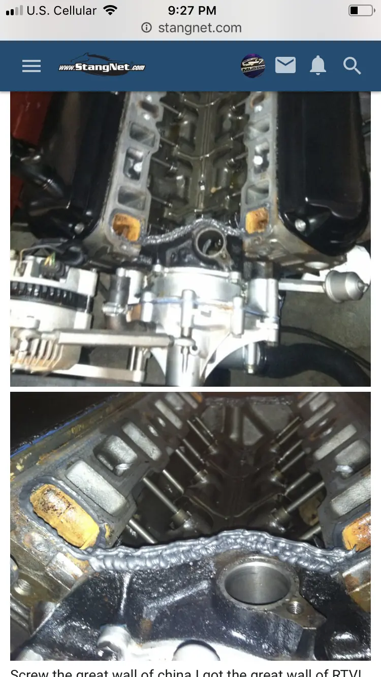

Just gonna leave this here.
srtthis said:
Screw the great wall of china I got the great wall of RTV! Let's see this **** leak now!
Reactions: General karthief

that damn thing never leaked again! was a bitch to get off but it didnt leak!
Reactions: General karthief and 95BlueStallion
