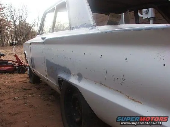

Man, I feel that 1/4" is pushing it, I don't like to see more than an 1/8". I've got some dents along the edge of the roofline (oilcanning) on my '63 where it looks like a kid might have crawled up on top of it or someone put something on top of it. I was thinking of using the heat and wet rag technique to shrink it up, I've never used it before, have you and how much heat do you think it'll take? All I have is a propane torch for soldering plumbing pipe. Actually, I have half of a oxy/acetylene rig, I'm missing the acetylene tank and regulator and the torch only has a welding tip on it. I'm thinking of eBaying the torch and purchasing a oxy/propane rig that I understand will also do actylene. The rig I have came with a old Craftsman Colormatic Arc welder I got off eBay for $20, I need new leads for it. My welder is a Miller 130 MIG I got about 8 years ago from a street rod show in town. I'm compressorless currently, I've got my eyes on a Ingersol Rand 80 gal single stage upright at Tractor Supply that puts out 18 SCFM @ 90 PSI for $750 as the good HVLP guns like their volume. My neighbor has a 600# pot media blasting rig that uses a diesel powered, trailer mounted Ingersol Rand compressor (like you see guys using jackhammers with) that has like a 1 1/2" dia. hose. I asked him how much to media blast my car and he told me, heck buy the media and the diesel and I'll show you how to use it and turn you loose on it. He's got the hood and the fresh air system and everything. He plans on building a 16'x24' building for doing paintwork in. I'm waiting until he gets that built so after I blast it, we can pull it into there and hit it with some DP48 (which is white, since I'll go with Corinthian White as the finish)
I guess I found my answer on the oilcanning technique. http://www.mustangmonthly.com/howto/20318/index.html
My new toy. Pretty fun spinning the car around. I must say that the Whirly Jig brand rotisserie is a pretty nice piece. All I've done here is to get it fitted to my '63 for future use. I'm taking off a few pieces that I won't need, but once I'm done with that, the car will be back on the ground and the rotisserie will move into the garage where it'll be mounted up to my '65 coupe.
A little blurry, but the rust holes in the passenger rear floor pan are easily seen.
I stretched the front of the wheel openings forward about 10 years ago, and it doesn't look bad, but found my technique of backing it up with another layer of metal was incorrect. I plan on correcting that but not until I can see how large of a slick I can fit back there. I'd like to fit a 31x10.5w, but I don't think that'll happen.
The black sharpie line shows how much I plan on notching the front of the framerail, which puts it about to the inside of the inside wall of the framerail. No worries, it'll get backed up by a 1 5/8" .083 chromoly tube that will support the rear suspension.

1/4" is a little heavy, but that is a good general rule of thumb. 1/8" is probably the thickest my car will see but there aren't supposed to be any major problems if applying up to 1/4". This also depends on where the putty is being applied. To answer your shrinking question, the oxygen acetylene will work fine. You heat up a dime size spot until it is bright red. Follow that up with a cool rag and you should see your metal warp or oil can go away. Another method is using a stainless shrinking disk on a buffer/grinder. This provides enough heat to essentially do the same thing, but without a flame. Here is a link to a shrinking disk which I am considering purchasing...
http://cgi.ebay.com/ebaymotors/Shrinking-Disc-Salvage-that-ratrod-project-or-Mustang_W0QQitemZ4653759310QQihZ002QQcategoryZ35000QQssPageNameZWDVWQQrdZ1QQcmdZViewItem
A good set of hammers, dollys, and a shrinking tool should get you close to skipping plastic filler altogether. I have never shrunk anything before so I am not guaranteeing any of these procedures. I have seen it done(in person, not on TV), but never done it myself. I will probably purchase that tool this week to cut down on putty, and my oil canning problems. In response to the small picture size, those are thumbnail links to the larger, more detailed pictures.
It looks like you have a fun and interesting project there. I sure wish I had the convenience of a rotisserie for my Mustang. We used one on the Fairlane/Thunderbolt project and it was GREAT!!!
Also, you mentioned using what sounds to be a very nice mig welding unit. I have been using a Hobart 120(Miller owns Hobart) for the last couple of years and was very pleased with it. The only thing I disliked was not the welder, but the consumables that the owner purchased. He had me using thirty thousands wire with straight CO2. The Co2 provides a hotter weld, and the wire was too thick for sheetmetal. Now I am running a borrowed Sears 80 amp with the correct 23 thousands wire and argon/Co2 mix. Much better. I need to save up and purchase my own but borrowing is just too easy! Have fun with your project and if you have any other questions with it just ask.:)
Edit: I just noticed that you mentioned a propane torch for heating. I also considered that at one time but someone told me thereafter that this was not a good idea. I am not sure why, but I avoided it just to be cautious.
Yeah, I've seen the disk before, the first ones that came out used a wavy edge, that's been about 15 years ago, seen it in Eastwoods catalog back then I believe. I've heard of guys using SS cookware lids or even old cheap sawblades that don't have carbide teeth. My problem is, I don't have a 7" or 9" grinder, only a 4" Dewalt.
Yeah, I have the 75/25 CO2/Argon mix and use the .023" on sheetmetal. I'm thinking of getting a stud gun at Harbor Freight or our other local cheap tool store.
Instead of buying a new floor pan, I'm thinking of using a old can of bondo I have and a sack of sand mix and clean up the floor and pour the sand mix with a bottle of bonding agent and make me a hammerform. I've been looking at a reason to try this out. I was going to make aluminum bumpers for my car, even emailed Ron Covell and asked him how to do it (he said to hammerform over the originals, do it in 3 pieces and weld the endcaps onto the center) and that seemed way too much work (I can see why I was quoted $2200 per bumper) so I have decided to use MirraChrome on some fiberglass bumpers instead.
The link I posted shows using a propane torch with a wet rag. I'll probably dent an old GMC (early 90's vintage) truck hood I have and practice on it. I've got hammers and dollys, planning on getting a slapper bar or making one and a porta-power.

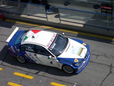

Now that we've established that Stanger '66 is the Mozart of custom bodywork (and tripled his post count in the process), I'm curious of the basis for his comments about the '67 track car. To recap, here's one of the pix:
attachment.php
Here are some of the comments:
"That car is hideous." "He butchered the car to the point where it is unsalvageable." "It is obvious that there was no time spent on that body." "Those german touring car flares look nothing like that crap he put on his car. They look like they took about a half an hour a piece, because they probably did."
That last one is particularly confusing, because to my eye the flares on the '67 look exactly like the ones on the German touring cars. I'll make allowances for youth and all, and there's no accounting for taste either, but these are objectively false statements.
I still agree with my previous statement about the flares. The German touring car flares were more rounded(slightly albeit) and had a much more gracious flow between the rocker panel and front valence.

Speaking of talking to a wall . . . well anyway, here's a pic of one of the Deutscher cars:
and here's the pic of Preston's:
attachment.php
Here's what you wrote:
"Those german touring car flares look nothing like that crap he put on his car."
So tell me, please, exactly how Preston's "crap" looks nothing like the Audi. Because to me the look exactly the same.
Maybe the first statement was a little harsh, I'll admit that much.
Your not talking to a wall here, I am trying to be flexible and understanding of everyone's likings now, instead of my one-sided view as before. I said that I still don't car for the flares, they are SIMILAR to the German touring cars, but not identical. I then stated the semi-subtle but present differences. What is the problem with this?:shrug:
Well, I'm sure Preston's aren't carbon fiber like the German touring cars are. And yes there are subtile differences, but you're also talking about probably a half million dollar touring car vs. Preston's carport built car, I don't expect him to have the same radius on the corner and he didn't flare them into the body or have the slight slope that the tops do, but for gosh sakes, he did it in a CARPORT!!! His flares have no waves and show a consistant reflection and a gar-un-tee they took more than "30 minutes" to do.
I've seen the bulged out fenders that a lot of these cars have and I think it looks just as terrible. The thing I like about these more is that you can still see the body lines.
Again, Preston has stated that he probably should have cut the car in half down the middle and added 8" to it, but he felt this would be a simpler solution. I don't know about you, but in my 39 years, I've done lots of things that I've thought out (I assumed) very well and once I was done exactly as I envisioned, I didn't like the way it turned out.
That said, I don't think there is that big of a difference to be as picky as you're being. The Audi is a bubble car whereas the Mustang is far more 'cut' (which I think we can ALL agree on).
