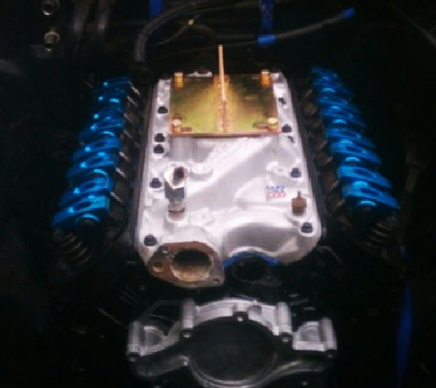

As far as the 351 would I be able to use my roller rockers and everything. I think the deck hight is an inch or so higher so I'd have to get different rods fir sure.
The Mexican block thing is bull:poo:. Stock blocks are all about the same. The newer the block the better. Less of a chance you will need a crank turn. I would do a set of forged pistons for the boost and run stock internals for the rest. The heads that came on the Explorer are better than the iron GT40 heads, but they require special headers. It might not be worth the hassle of making them work with the on3 kit. Be careful on the boost. Too much and you will crack it. However I wouldn't jump the gun for a better block, because I would gather that the rest of your drivetrain is not set up for the power a stock block can handle, that's to say you will probably break something else first.
