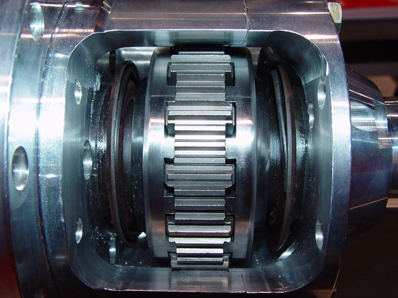

Here's a cutaway of a Detroit locker. I guess those are spider gears, but if they're broken, you need a whole new unit.
Mark- I always popped the clutch before the damage. Now I just let the clutch up a little and I get a lot of clunking noises. I can't let the clutch engage. I'll figure it all out once the center is removed.
1badII- Thanks for the picture. I couldn't find anything in my Chilton or Motor manuals on the Detroit centers. I'd post pictures of the damage when I remove the center but didn't figure out how to do that yet.
