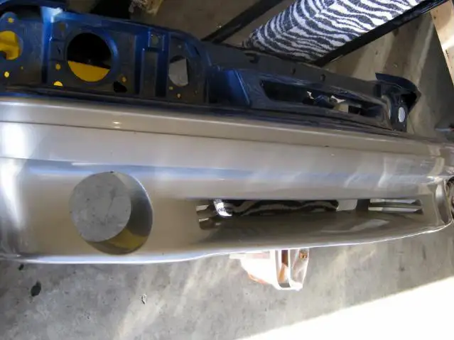

Here's a pic, rivets on the top and 2 sided tape:
