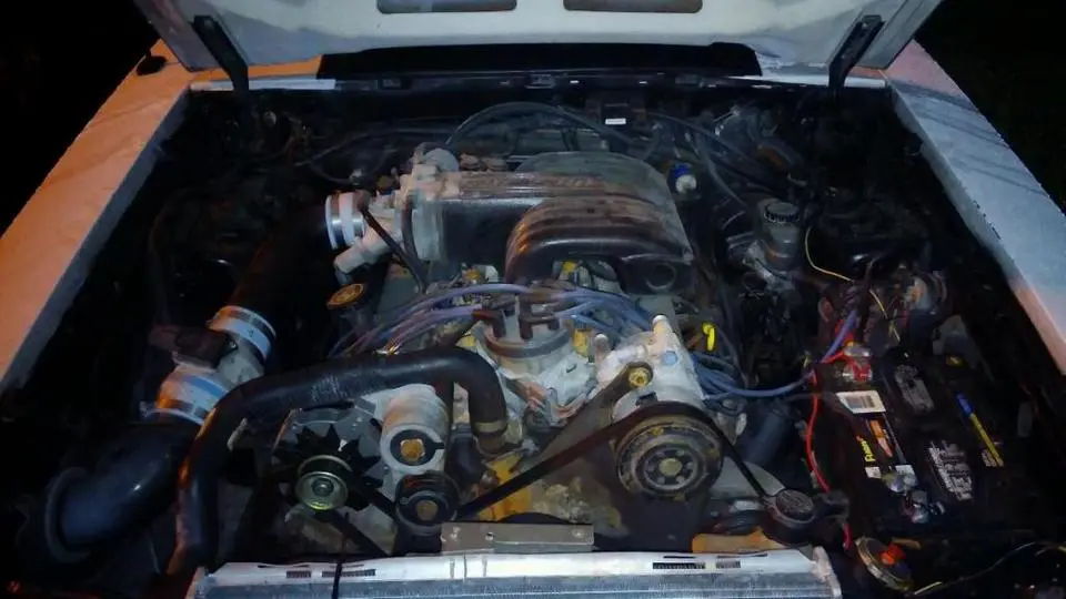

OK, heres the engine pic. Still have not gone to look at it. That is Saturday.

The pic is too dark to see much, but that water pump looks ugly

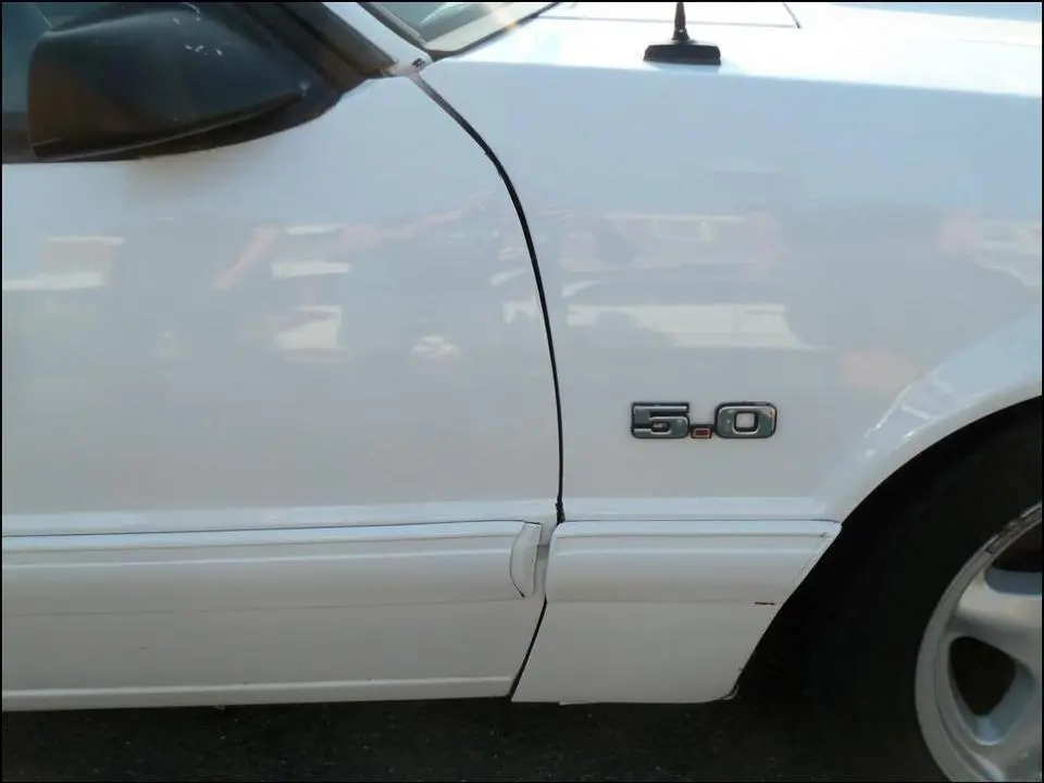

The car was an overall rag with dozens of nickle and dime stuff messed up. We walked without making an offer due to rust and accident damage evidence. The pictures show some of the deal killers.
Front fenders out of alignment.

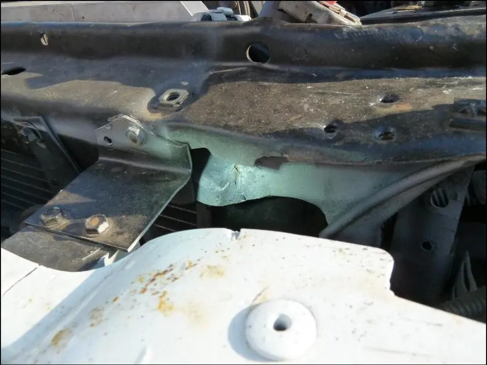

Accident damage at radiator support.

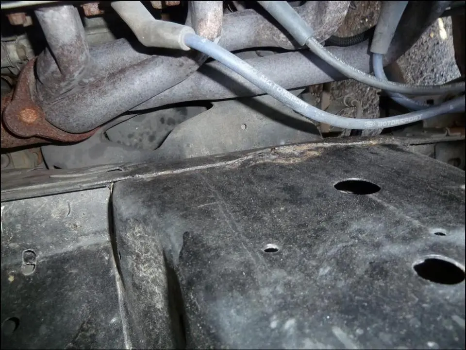

Accident damage at front drivers side frame rail

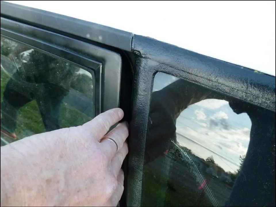

Huge gap at drivers side window frame to body. Yes, the door is fully closed in this picture.

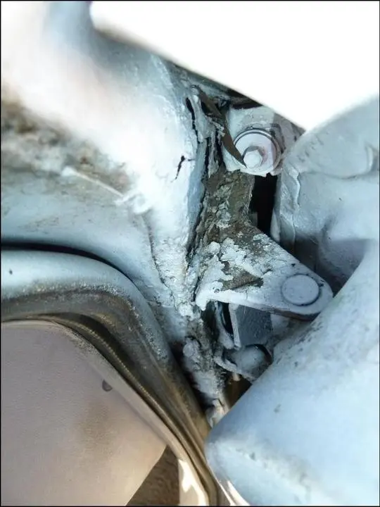

Severe rust in door jamb at hinge location passenger side. Lame attempt to conceal with spray paint.
