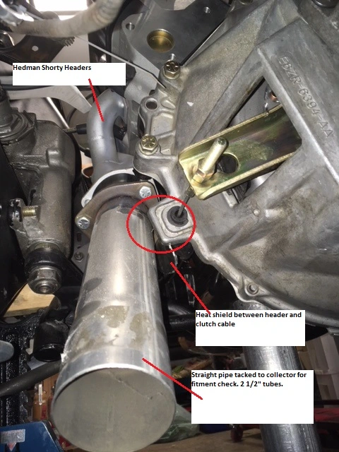

I'm getting around to looking at doing the exhaust. I'm running non-ceramic Hedman shorty headers (I did paint them with a ceramic paint and baked in oven though) and 2 1/2" exhaust. On the drivers side the collector exits very near the cable clutch so I did up a homemade heat shield using steel with hi-heat paint and a layer of anti-heat matting. Installed it between the header pipe and the clutch cable.
Think this will suffice or do you think I should angle the down pipe slightly away from this area (I'm not sure that would help much though)?
Also, does anyone know where to physically locate a h-pipe? I'm not sure where to locate it exactly.
I'm running a T5 transmission and am using the cable clutch setup.
