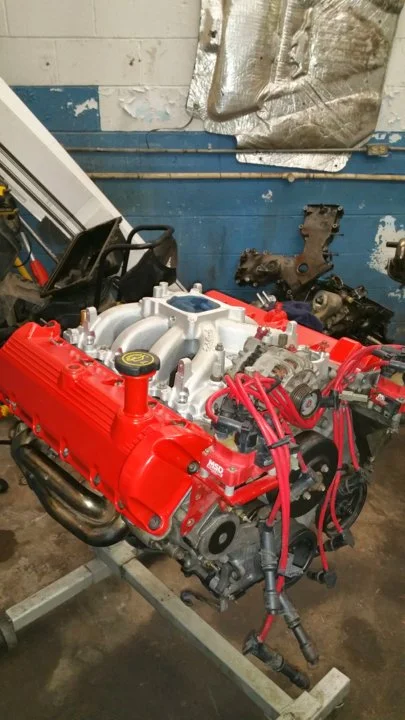

  • #20
I have the edelbrock victor jr w/ the fuel rails i love the setup but hated the purchasing and putting it together its the most incomplete mod in my opinion. But the intake is great and i love the power
