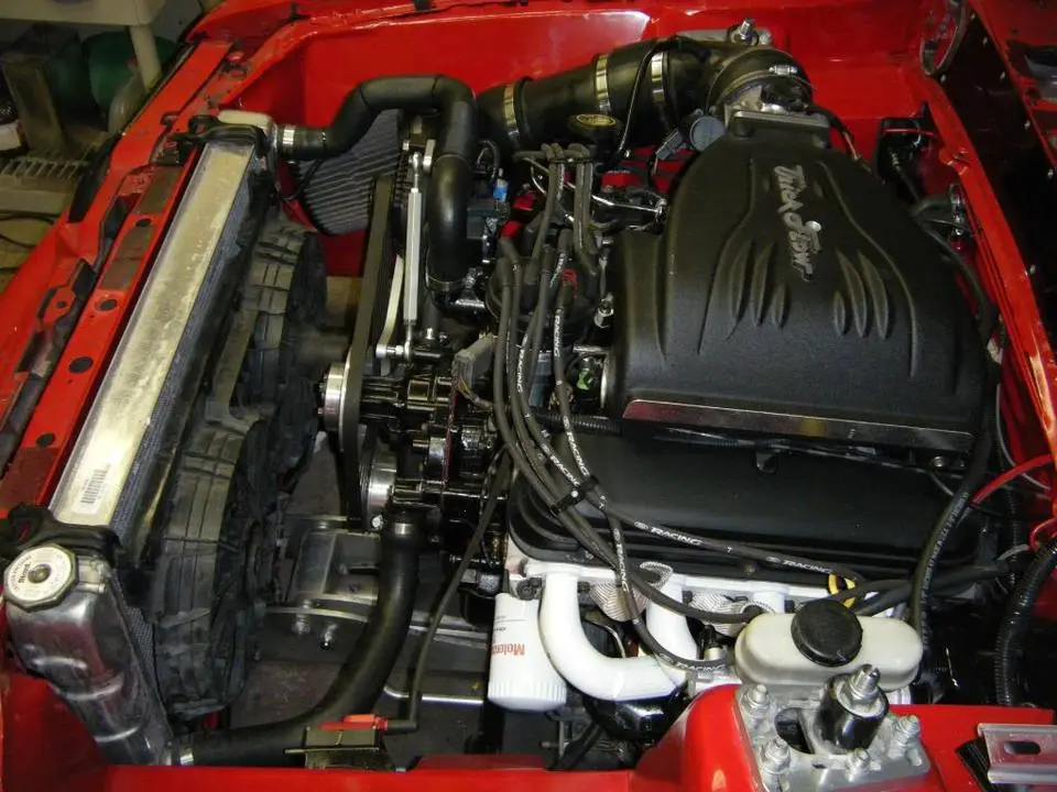

Heres a pic of mine,all i have is water pump and alt. This isnt routed properly cause my belt is a ribbed belt,but the only draw back i see in mine is the belt slips a touch and is kinda wearing a groove into the water pump pully. peace
