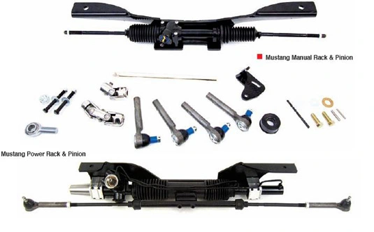

i'm not saying the Steeroids is a bad kit kit by an means, just that i think Randalls is a little better. to add one more to the J-car rack kits Unisteer has just come out with their power rack kit and it too uses the J-car rack. it also looks to be maybe a little better than the Steeroids kit because of the mounting cage/frame they use. i can't find it on their website right now because it's so new but i do have a pic of it

Which kit are you showing? Isn't the location of the input shaft too far in the middle of that system that the universal joints would be binding? Isn't a system with an input shaft close to the old steering box better for this?

the top kit is the manual steer rack for the mustangs, several people have installed them and some have had u-joint problems but they've all been able to get them worked out with unisteer to the best of my knowledge, this required using 3 u-joints. the bottom kit is the power rack and it's just a J-car rack like the Steeroids and Randalls units. the input shaft placement on the power rack should be fine.
