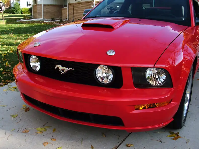

They can go anywhere as long as you can get the scuff plates and pins to align properly. I put mine way out near the edges of the hood and I didn't get the angle and/or rotation of the scuff plates correct and they were off a bit, but functioned. I used the factory holes just outboard of the rubber hood stops on the radiator support. IMO, they look much nicer further out than closer to the center of the hood. One of the easiest ways to mount the pins is to get the brackets that mount to your upper radiator support.

bigcat said:
john, got an underhood shot of the exact location you used?
The best I have, but posting the fullsize pic, it's easily seen...and you can see the hole in the underside of the hood as well.
