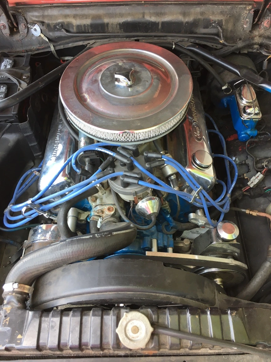

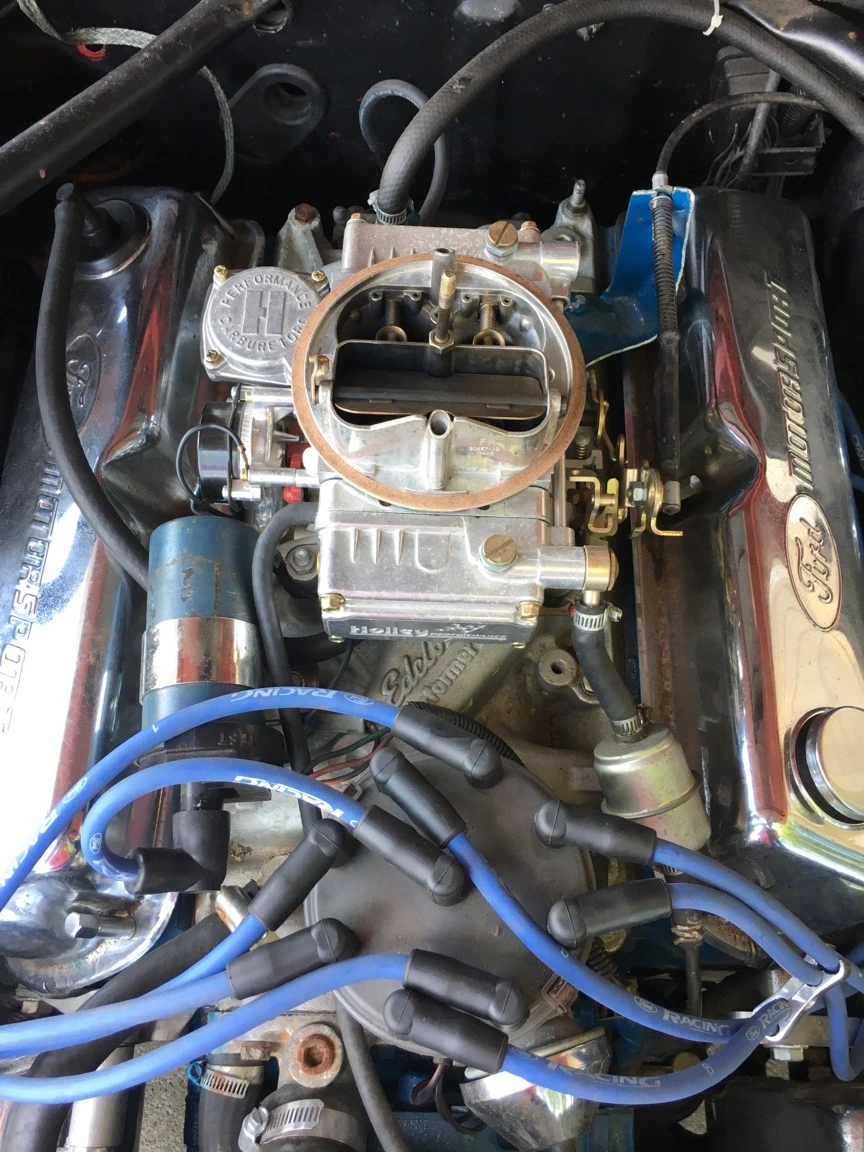

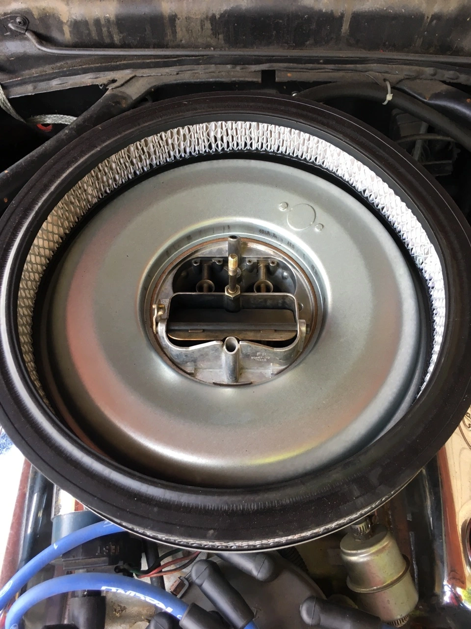

Post some pics of the engine, carb and intake in particular.

Here's a few pics, black on the carb was there before from the backfiring issue

Everything under the valve covers is uncharted territory for me, so I was really hoping I hadn't ruined something in there. Heads, carb seal, gasket, valves, etc.
She's old school, no brain box, but the iggy is original and engine mounted so if that went it would make a lot of sense, I'll give the electrical system a good going over
And overhaul the coolant system :nice:
Check the Duraspark box on driver's fender.
Mustang II engine compartments don't evacuate heat very well, and if it overheated, the resin in the Duraspark box could have melted, which result in a loss of power and stalling when warmed up even though it would start just fine while cool.
