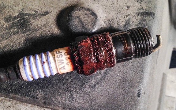

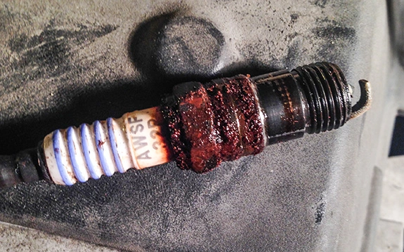

Did coolant get all over the motor? My plastic intake manifold finally cracked on me a few months back and after installing a new manifold the car had a miss. Coolant got into some of my spark plugs wells and fried one of my COP's. After replacing it the car ran fine again. Fingers crossed it's not something more serious.

Thanks so much, that sounds very logical!!! the manifold broke right above the rear coil packs in the right bank of the engine.... dumped water all over there...

I had this same problem after hosing down the engine bay with the pressure washer. Pulled the coils and found water standing in a couple. Blew the water out with the air compressor and it fixed the issue. Also possible that a coil failed, but you would most likely see a CEL.

Thanks so much, I ended up pulling the plugs and replacing all of them, they looked awful, wet, and the coils were nasty and even rusty looking and very wet....

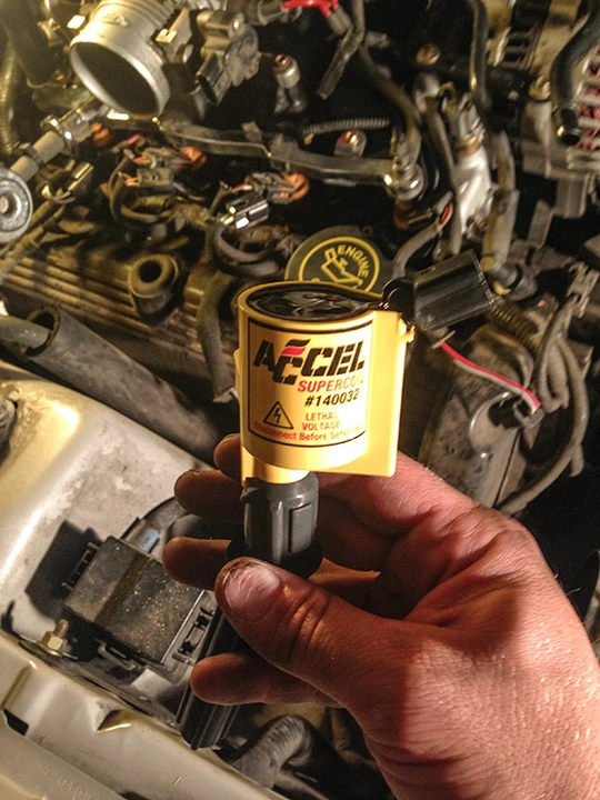

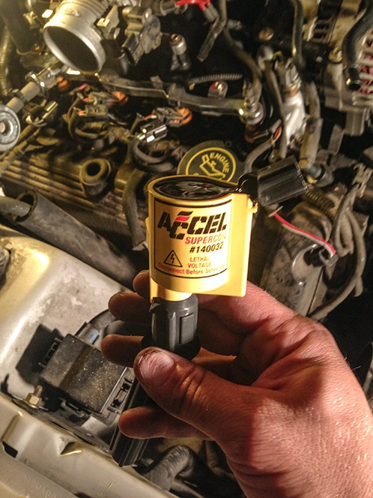

I bought a new set of Accel coils and replaced the plugs, car runs perfect now.
Old plugs looked bad:
new coil packs look cool :)
