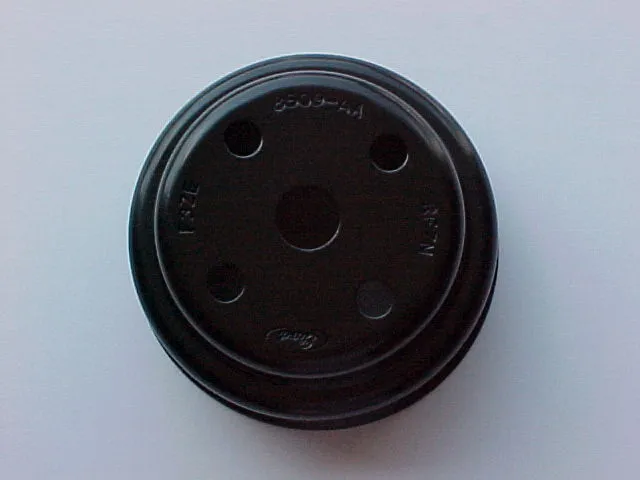

Water pump's bearings and seals go. So, a bad water pump is one that leaks. A water pump impeller's blades get very little wear. So, a "bad" water pump isn't your problem.
Do you have under-drive pulleys on the car? What engine mods do you have? Are those temps with the AC running?
The Fox cooling is barely adequate for a stock engine. That's why Ford used a smaller water pump pulley for the '93 Cobra.
A higher flow water pump may help.
A smaller '93 Cobra water pump pulley should help. But, you may also likely need a shorter belt! That's why mine is still in the box. It's on my long list of "stuff to do when I get a chance".
PPI still sells the pulleys: $75 plus S&H. Yea, I also paid a lot for mine.
PPI | Engine | 1979-1993
1993 Cobra water pump pulley, genuine F3ZZ-8509-A over-drive pulley that accelerates water pump delivering greater coolant volume to 1979-1993 5.0L engines without cavitation issues, very limited quantities, new...view $ 74.99/each

BTW: As I remember, those pulleys have been sold out for a while. So, I was surprised to see them listed again. Then, after a Google search, I just found the posts by PPI below on another site:
'93 COBRA WATER PUMP PULLEY... THE LAST OF 'EM!!!
We have a very limited quantity of brand new (NOS) 1993 Cobra water pump pulleys!!! These are genuine F3ZZ-8509-A pulleys that are impossible to find new or used!!! Order on-line or call ASAP as a sell-out is assured!!!
A sell-out is near... These have gone for over $100.00+ on eBay...

If the temp sensor was bad/off_a_lot, then he wouldn't see the temps going down at highway speeds.
A 93 Cobra pulley will not only increase the water pump flow, but also (as important, if not more) increase the fan rate.
Which Fluidyne radiator did you get? What's the width? IMHO, some aluminum radiators don't cool any better than the older 3-core. The FRPP aluminum radiator, or Summit general purpose aluminum radiator (for manual cars only) are the best/biggest you can stuff into a Fox.
Also, they make an "FRPP police package" thermal clutch. It has less slip at idle. A good thermal clutch has very little power loss on the highway. The thermal spring "opens", and there is very little HP loss (~3-4 HP) on the highway.
