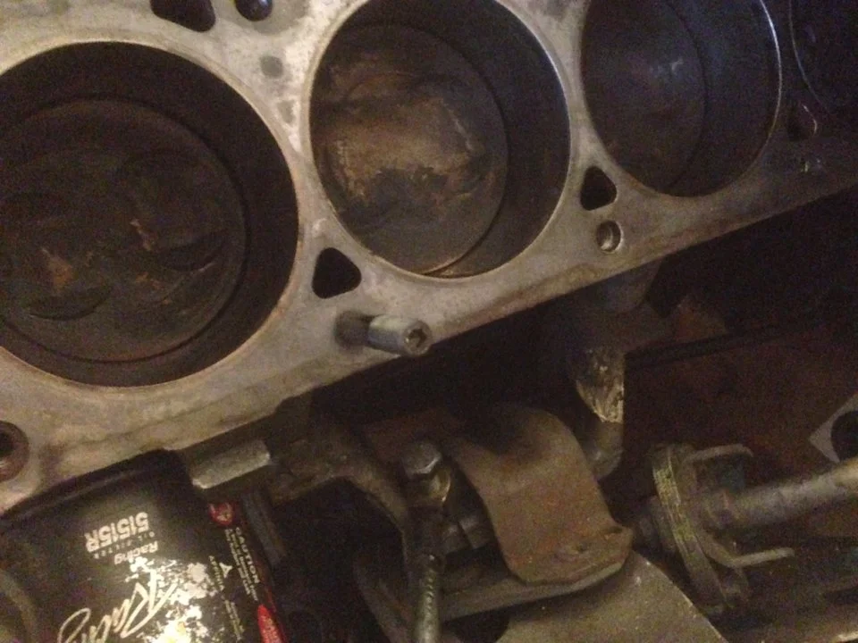

Great news on those heads. All your hard work is paying off! Like I said before, even though you found out the heads are ok and technically you may not of needed to remove them after all, think of the money and time you would have spent tearing it all back down again because you didn't check them and there was a problem. You can now sleep at night, you know what you got under the hood.
Not to mention you found cylinder scratches. Not the end of the world but you now know your going to need a rebuild soon if you plan to apply pressure to the rear wheels anytime soon...
A scratch in the cylinder wall that you catch with a finger nail isn't good. But it's not necessarily a show stopper either. It's going to be a source of blow-by. How far down the cylinder does the scratch extend? Probably the full length of piston travel I'm going to assume. Usually is the piston skirt that has dragged some FM up and down the cylinder that got past the piston rings or came from the oil pan up.
I have the same thing in 2 of my cylinders. I decided to leave it and run them anyways but I plan on future rebuild again soon. I also have a supercharger installed. I've been running it this way for a while now with no issues as of yet but I'm only driving it on weekends and not on a track.
Just know if you decide to reassemble now you will eventually see problems later. Might be thousands of miles down the road(if you don't run her hard) or it could be sooner.
In the old days, a guy would have not looked twice at the scratch and just slapped her together and ran her till the engine blew up. Probably would last a long while too but in the end she'd be eating oil and guzzling gasoline. Really depends on your plans. Daily driver? I'd slap her together and run it. Plan on upgrades and hard runs in the near future, stop and rebuild it now.

Yea I've learned the little bit I know from guys with that old school mentality. My buddy that races buicks once R&rR'd head-gaskets on his turbo Buick in the pits at a local track. The pits are on the lawn and he definitely got some grass on that head. Ran a 10 second pass and then he drove it home 2 hours. Im obviously taking more time on this.

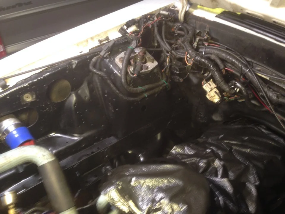

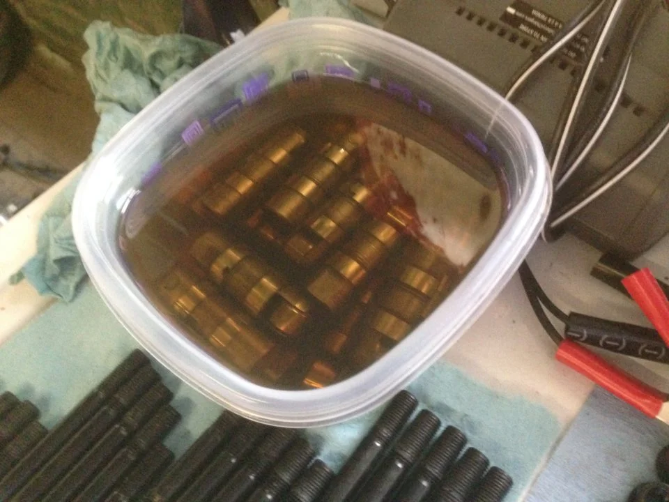

Currently waiting on some paint to dry as I wanted to take the opportunity to throw some paint on parts of the chassis that were rusty. Lifters are soaking in cheap oil. Got almost all the gasket material off and chased the threads with my homemade chaser that cost me 30 cents. Once the paint dries I'll be going over the blocks surface once more as well as cleaning the piston heads a bit just for giggles (I know they'll just get gross again after a few hundred miles but what the heck.) Hopefully will have the heads on and ready for intake tomorrow. Hoping to drive my girlfriend to church on sunday

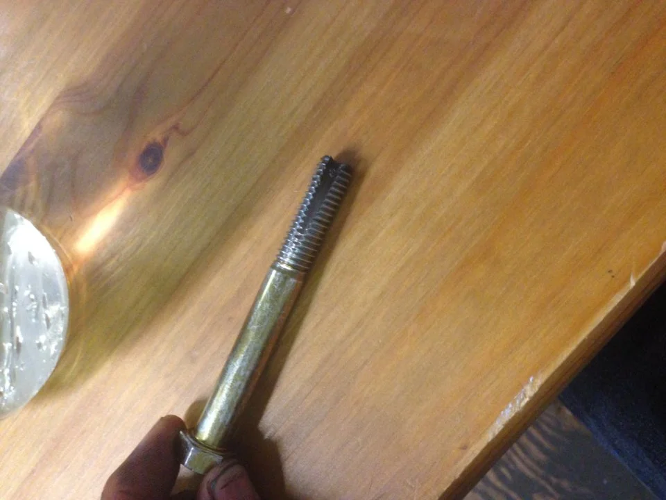

Also, I accidentally stripped the little allen socket on one of the ARP bolts last night while I was super tired. No way am I paying for a new set of ARP studs because of one that messed up so I just elected to leave it in and clean the best I can around it. Once this longblock breathes its last I'll get new head studs.

Going to be to be ready to assemble the valve train soon. Any advice on that lifter preload? Some instructions are super simple, some are ridiculously theoretical.

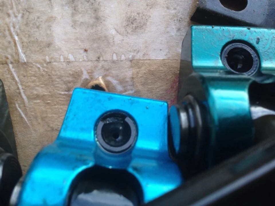

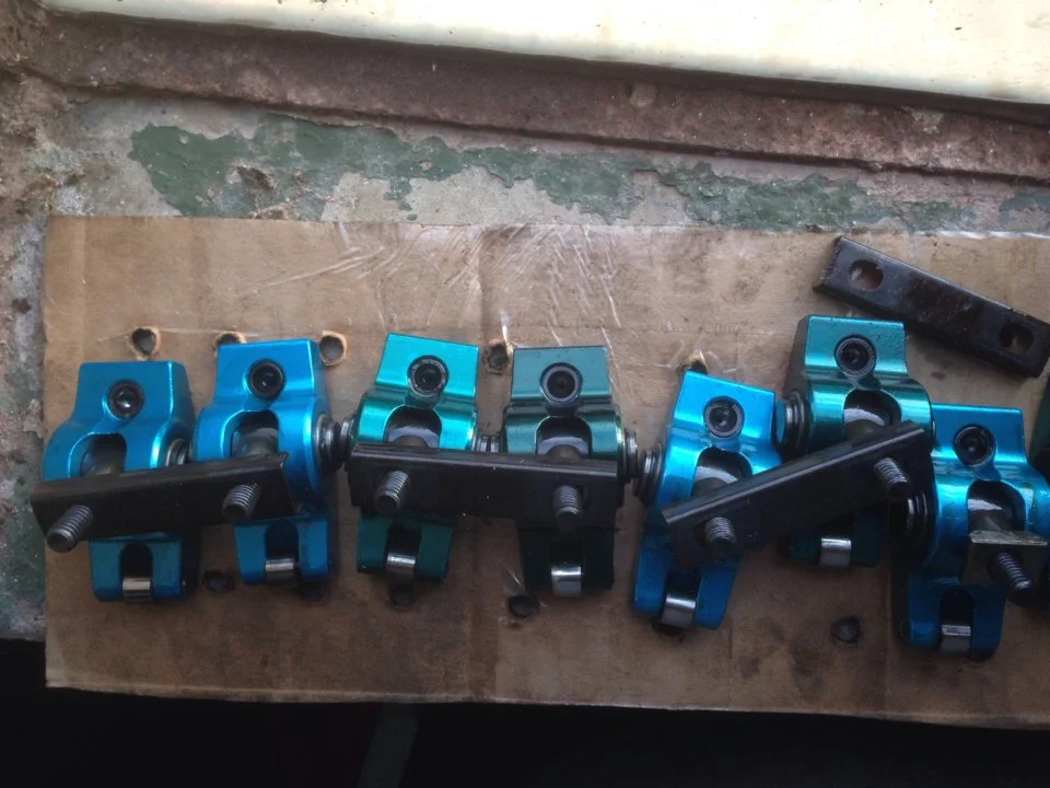

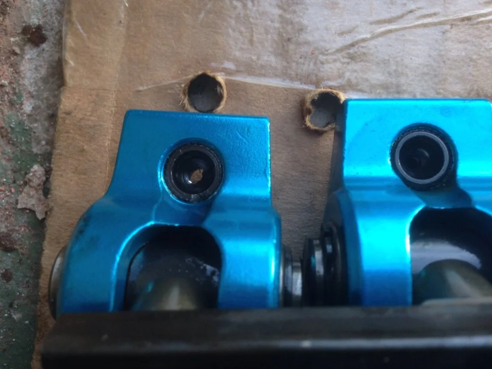

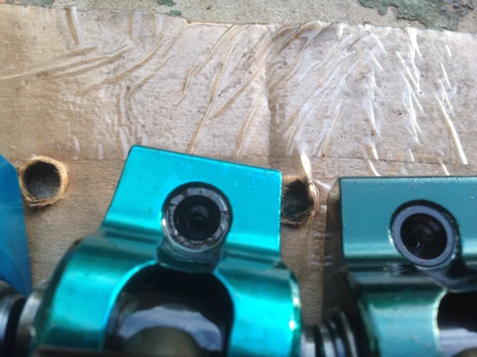

Well this is demoralizing. Pictures worth a thousand words:
As you can see most of the pushrod cups are severely damaged. If you look closely you'll see one that is actually so bad that you can see through to the cardboard. What the hell could have cause this? Preload too tight? I noticed there are no locks on these. Just one Allen screw to tighten. I plan on getting new ones Monday but don't want the same thing to happen to new ones. What else do I need to check beside preload?
I know this is a dumb question but would it be a bad idea to run the car with these? I just want to fire it to make sure I didn't screw up the install.
DId you shim them properly and/or use the correct length pushrods? What did you set the preload. at?
I did not install these. I researched a bit and will be double checking the pushrod length before ordering new rockers. None of them were shimmed.
There is your problem. Pedestal mounted rockers require shims
I always thought that was a bandaid. these heads have been ported/ machined. isnt it possible they have been adjusted for the rocker/pushrod length?
Sure it is possible but I didn't see you assemble the engine.
To get the corrrect preload on the pedestal mount rockers
1) Rotate motor so a pair of rockers are on the base circle of the cam (both valves completely closed).
2) Loosen both rockers til you have some lash between rocker ends and pushrod tip.
3) One hand on the socket, one hand on the rocker -- slowly tighten bolt whilemoving the rocker arm back and forthr with the other hand.
4) When the rocker just barely reaches the point where you no longer have any gap on either end and you feel a drag when you spin the pushrod you are at zero lash.
5) Torque down the rocker arm and count the number of turns it takes to reach 20 ft-lbs.You should reach 20 ft-lbs. somewhere between 1/4 and 1 turn of the bolt. If you do - your preload is in the required range.
6) If it takes more than one turn- your pushrods are too long and you use shims to raise that rocker until you hit the required torque between 1/4 turn and 1 turn or get different size pushrods.
7) If it takes less than 1/4 turn your pushrods are too short. You can either remove clearence the bottom of the rockers, or get shorter pushrods.
