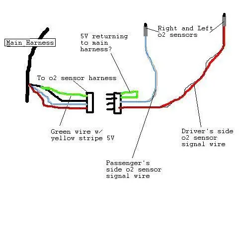

Today I pulled off my oxygen sensor harness. I'm going to try to make my own, just to eliminate it as a possible failure. I also pulled my oxygen sensors out. When I shake them they rattle. Does this mean they're toast?
Also, I found one prong on the main harness that goes to the oxygen sensor harness that puts out 5V. That's the only prong that puts out voltage at all. I assume that is the power for the heaters in the oxygen sensors. The wire in the oxygen sensor harness that connects to this prong is just a loop that reconnects to the main harness. I've included a picture to better explain this. There are a few more wires in the harnesses but I didn't include them since they don't relate to what I'm talking about.
I tested the ends of the oxygen sensor harness that connect directly to the oxygen sensors and they don't get that 5V. So something is wrong. There is no way that I can see for the oxygen sensors to receive that 5V because the wire just loops back into the main harness. The loop is definetly factory.
Anybody have any ideas?

Try heating the O2 sensors with a propane torch and making your measurements. It should give you some voltage out within the 100-800 Millivolt range.
The O2 sensor heaters use switched 12 volts from the ignition switch. If you probed the O2 heater wire and got 5 volts, either you probed the wrong wire or someone crosswired things. There is no place in the O2 sensor circuit that should read 5 volts.
All I know is that the connector that plugs into the oxygen sensor harness only had one prong giving out voltage, and that was 5V DC. The heater signal is the only thing that should be putting out voltage, right? Well, that 5V DC only comes on with the ignition switched to ON, so I assume that's the heater signal.
Where does the heater signal come from, the computer? I want to track it down. It's a green wire with a yellow stripe. I'm about to just eliminate the connections and the harness and wire that 5V wire straight to the oxygen sensors.
But oxygen sensors aren't supposed to rattle when shaken, are they?
