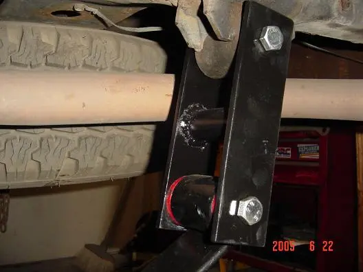

i broke my shackle.. already broken but still holding. so i made some.
problem is the old shackle keeps turning when i try to take off the nut(because its broken)
so hopefully i can tack weld it without burning the bushing. i guess i can cut the nut off.
or maybe you all have a better idea.
will the new ones i made work if they have this middle reinforcement? i havent done the middle mod yet, but i am thinking about it...that is if it would work...
not my pic!!
maybe that wouldnt work, heres a stang one..(not sure how or which way it moves while driving!)

That first shackle is connected to an extended bracket on the frame unlike the second photo that is attached to the frame only.
I like the looks of the first pic, they did a nice job fabricating that.
I think it would work in your case but the center support would have to be lower
than what is shown on the bracketed mount in the pic.
Looking at the 2nd pic, you'd have to add length (over the stock size shown) to get the support bar in and not contact the frame during suspension movement.
I'd estimate a 1/4" from the support bar from the leaf connection should be allright as a minumum.
Support bar to frame I'd give an 1 1/2" as a minimum?
