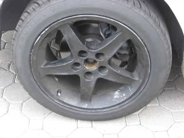

Anyone have experience with stripping paint and then polishing aluminum wheels??? The previous owner painted them (more like botched) black.
Is there a way to get a high polished shine? I really like the cobra wheels, but would love to have them polished aluminum.
BTW, here's what I'm working with.
