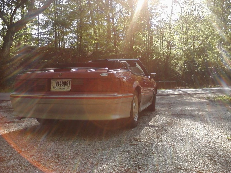

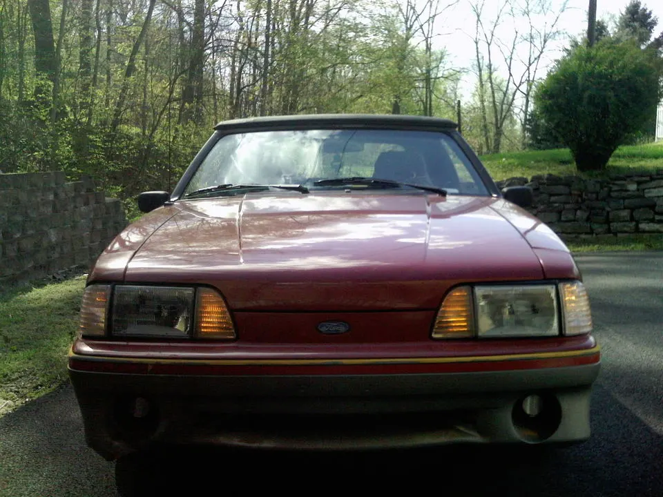

Well the paint isnt flacking, its fadded through, around the edges of the bumpers the yellow foaming ( or whatever ) is showing. Here is a picture..
